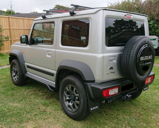

CC Baxter wrote: Thanks Gadget I have followed your lead and joined the rock slider set.
All I can add is I chose to run a tap through all the threads on the slider itself (M12 coarse). I found the things so awkward I wanted all the bolts to go in first time.
I didn't use a jack or ramps and relied on the old gearbox on belly technique (on the principle that it can't fall on you if it's already on you). The only extra piece of advice I can offer is to phone a friend, this has got to be easier with two.
Chris
[/quote
Look great!

Very nice

For all I have against the additional weight of these they are actually quite discreet, especially compared to the Italian ones.
