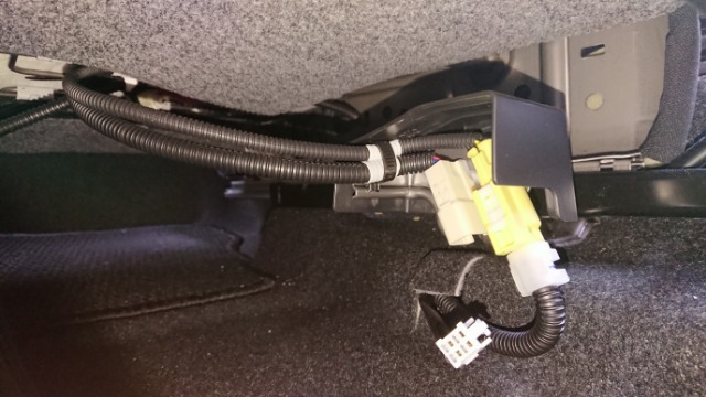

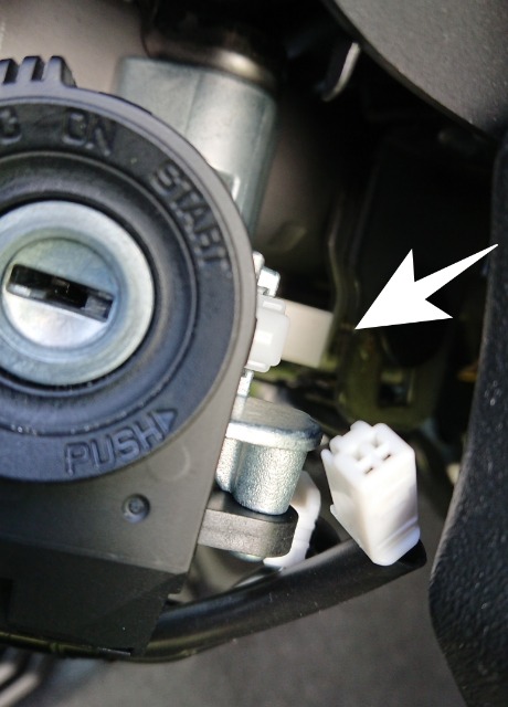

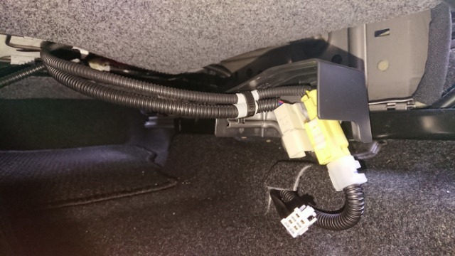

Replied by CC Baxter on topic Seat belt buzzer termination? (Gen 4)
This one's for you Andy, pull this 4 pin plug and no more seatbelt warning on the driver's side (which I think is what you were after). Trouble is no more heated seat either, four wires two for seat heater two for belt alarm. I will investigate further in the future (seat out) but for now this is good enough.

- Andy2640
17 Aug 2019 20:57 #212222
by Andy2640
That is mega appreciated CCB! Thank you mate.
I dont use the heated poo cooker anyway, so no worries there.
Great stuff, cheers!!
