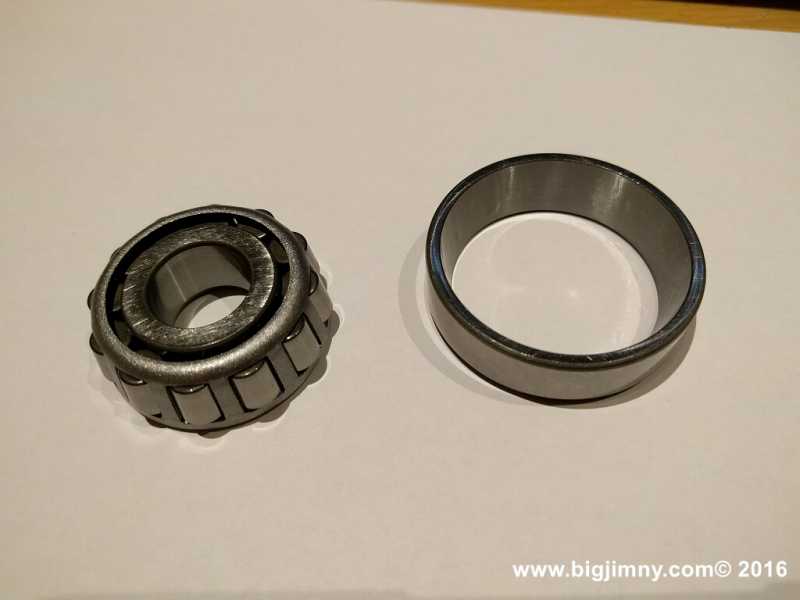

I realise English is not your first language ( you write it well?) Can I just check what you are saying. The kingpin bearing comes in two parts, the inner race and rollers comes as one part. The outer race comes as a separate part. This outer race has to be pressed into the swivel housing on the axle. Can I ask if you are mistaking this outer race as a machined seat in the axle, as it is not and it is simply replaced

When I said that we suspect that a wheel bearing race might have deformed an axle swivel seat, I meant the outer bearing ring (the ring which comes as a separate part when you buy the bearing).

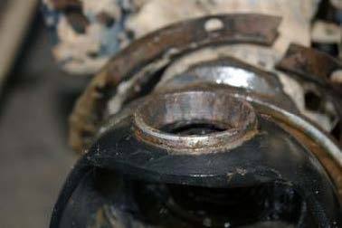

14 May 2016 21:11 - 14 May 2016 21:11 #166785
Here is the outer race in place in Swivel, it is this part that is replaceable as it comes with the bearing.
Replied by mlines on topic Jimny front axle

It is possible to get a man with a milling machine to recut the axle so as to remove the oval in the bearing seat which is why I have kept my original axle, however when I have sought quotes from local machinists it appears to be quite involved as an operation and is reflected in the prices given for the work, certainly in comparison with a new second hand one. If however as you suggest there are very few Jimny in your area then repair may be significantly more affordable than replacement. My understanding of the procedure is to cut the seat to a larger true circle and relieve for a full penetrative weld, press in a suitable repair ring or blank, weld in, dress back to the swivel profile then recut new seat to proper specification, hence the cost, it's fairly simple but quite time consuming.

Martin, your picture portrays as I described.
My mechanic fears that the bearing's outer race ring has deformed the axle hole in which it sits pressed (as we heard a snapping bang each time a stuck bearing gets unstuck by the force of the power steering).
If the axle swivel's seat / hole is deformed, then a machinist repair process is needed just as 11/60 has described (or an entire replacement axle!).
