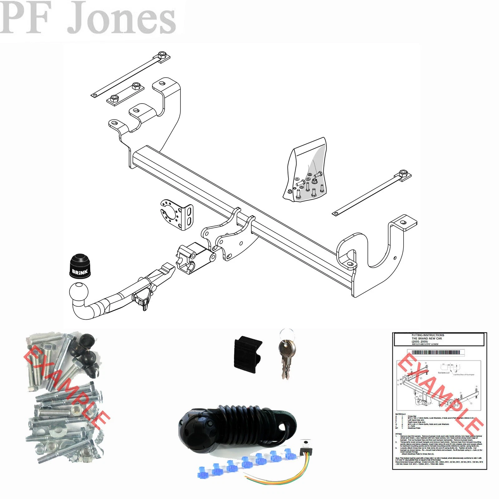

Amazing Busta, the one pictured on the top is the exact same as the one I got now.
The detachable part is so worn that I can swing the Hitch ball from side to side +/- 1-2cm.
I think I'll just grind off the bracket on it and weld on a new reciever but higher than the one pictured here.
