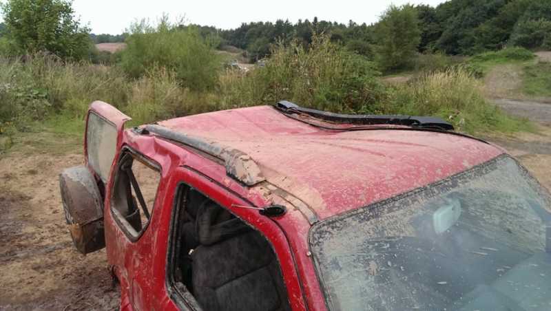

Jimny + high speed crash? What you got under your Jimny's bonnet?
Seriously though - that red Jimny with the dent in the roof is written off from doing no more than I did plopping it on it's side, so even a cage like ours is better than no cage.
Replied by kirkynut on topic roll cage inspiration
darthloachie wrote: so think I'll keep my external cage even if won't protect me on a high speed crash

And the nutter behind the wheel also owns a jimny with a cage. I think he just don't like Blue
The red jimny was past being on the road due to rust.
I will be sticking with my external cage just for some pay and play insurance.
