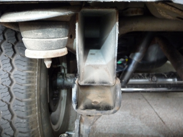

As the temperature dropped a little I thought I would check out the rear end ready to fit my tow-bar.
The bumper removal was a piece of cake thanks to all the info on the forum.
Once again I am very pleased with what I find that is out of sight most of the time.

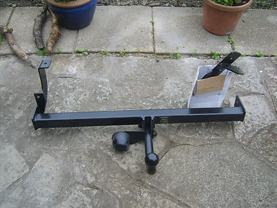

My tow-bar is at present in two pieces, the main bar has a fixing at one end & the other fitting bolts to it.
My intention is to have a 'quick remove Tow-bar' just four bolts.
I'll update once the bar has been modified ................
