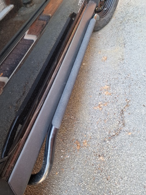

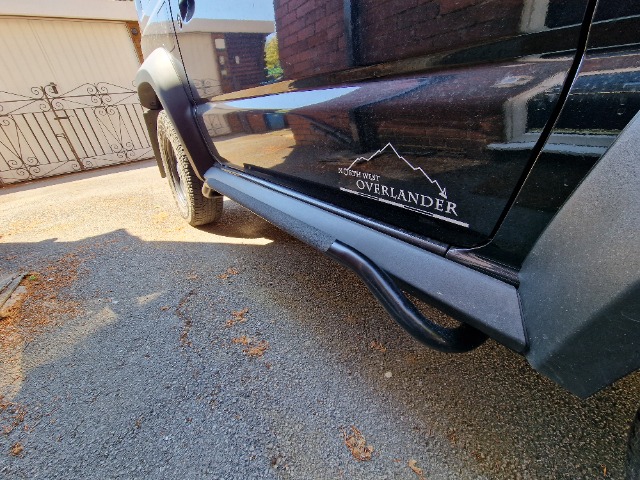

Replied by Soeley on topic What did you do to your jimny today?
Fitted some 'Grip Tape' to the Rocksliders. Although it's not long since I had them re-powder coated. Scuffs were showing already through standing on them as a step.
I hope no one opens thier door on them to get in/out, because they will have a nicely sanded door edge

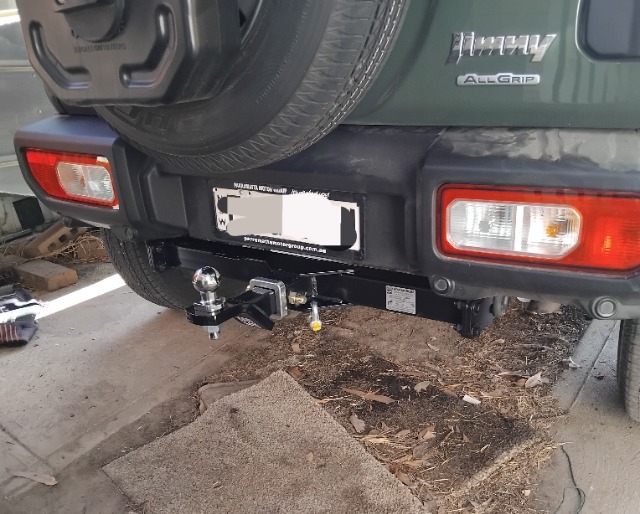

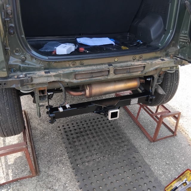

25 May 2024 15:54 #256097
I really like the 2” receiver tow bars you get over there, it means you can attach something else, like a winch if you want. They aren’t very common here, which is a real shame.
I am a bit surprised that the wiring harness is different for the 5 door, mostly cars are fitted with the tow bar wiring down to the back of the vehicle, but Suzuki must have done something different on the 5 door.
Robin
Robin

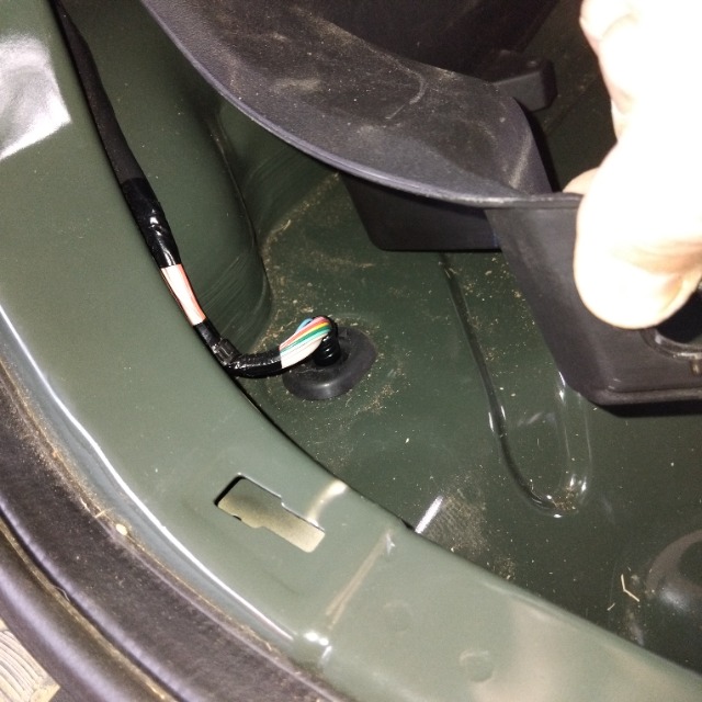

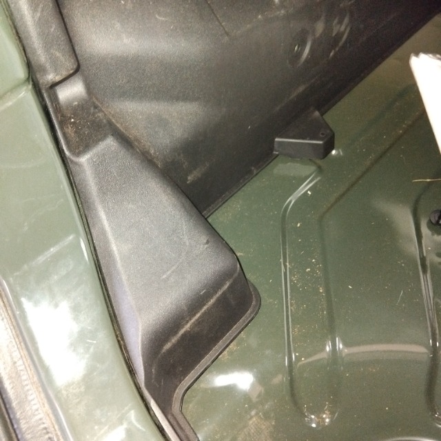

25 May 2024 23:16 #256099
by Bob9863
Replied by Bob9863 on topic What did you do to your jimny today?
There's two problems with it, the 1st is that the power lead is a bit short, the 5 door is of course longer so the 3 door harness is about a foot too short, it will reach but not neatly.
the 2nd thereat the harness ecu has nowhere to fit in the back, it's designed to mount on the side wall and earth to the seat bolt, but there's no room in the 5 door fir it to fit as the trim hugs the body a lot closer.
This is all the space you have to work with, and you are supposed to rldrill a 30mm hole to fit it, and seal it with a grommet, but there's no space to work with.
