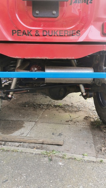

Tried to start the car after doing alot of work. Made a lot of noise.
But does an aftermarket SJ/Samurai Centerforce clutch fit a m13 2005 Jimny you might ask?
Well allmost. Or maybe is more correct.
The Centerforce sentrifugal weights interfere with the clutch release arm so trying agan today with the weights removed.

Had the gearbox back in and now it all works.
A clutch is a clutch on a jimny it seems. My 05 now has a clutch I bought for my 85.
