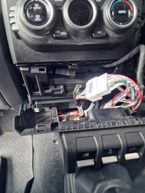

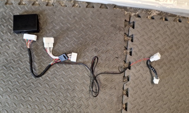

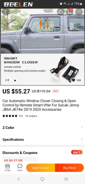

Not done any mods for a while, as I have my Jimny pretty much how I want it. But I saw a magic box on Aliexpress and thought it would be worth a try.
Basically it opens and closes your windows using the remote key fob.
It is working as it should and one bonus which I didn't expect, is that it has now turned the passenger side window into a one touch button, the same as the drivers window
Choose LHD or RHD when ordering.
The loom as it comes, no cutting or splicing into the Suzuki wiring at all.

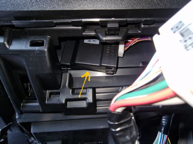

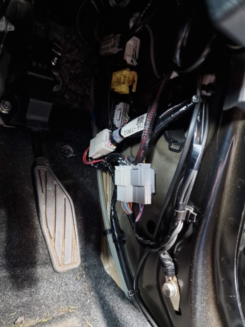

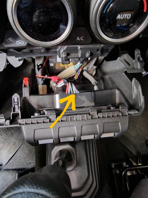

Remove the connector from behind the switch panel.
Plug the loom into the switch panel and connect the loom to the Suzuki connector.
Plenty of room up there to stick the module box and place the wiring.

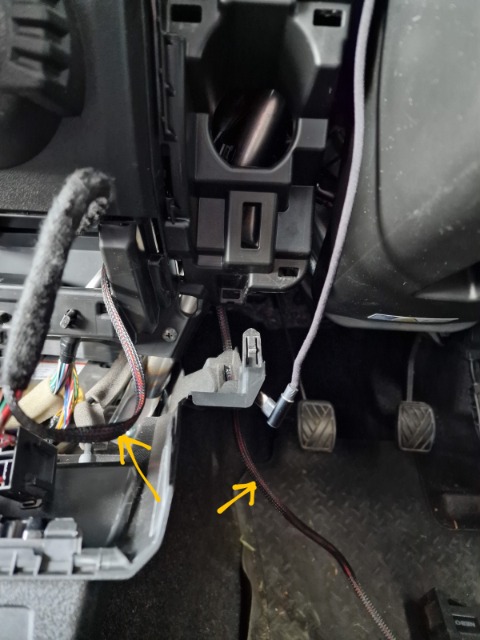

Feed the long wire out across to the driver's side.

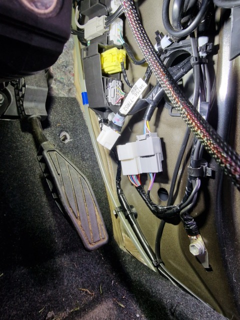

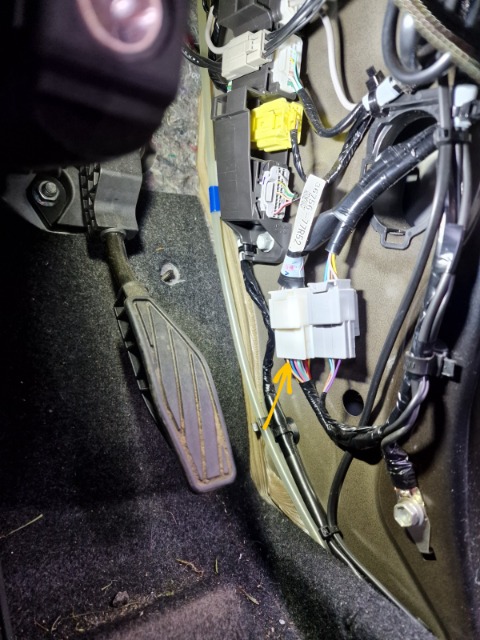

Behind the trim panel is the connector that feeds the wires through into the door.
Unplug.
And connect up the loom same as before.

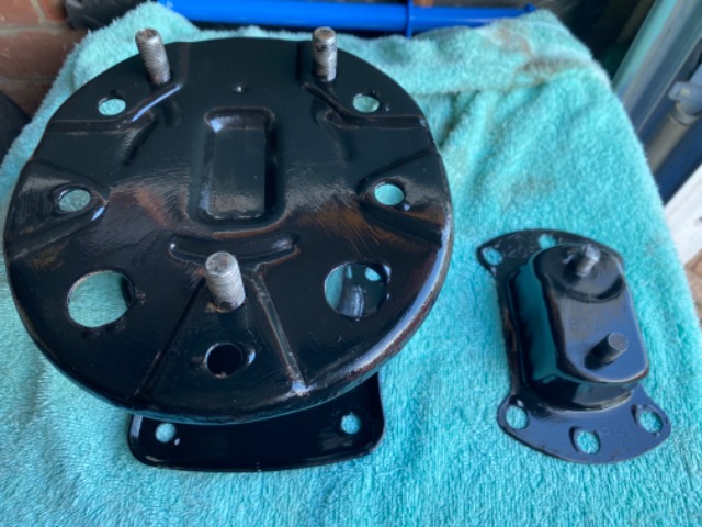

Painted the spare wheel carrier. Not my best brush work, but at least a good thick coat of Hammerite will keep it rust free.
