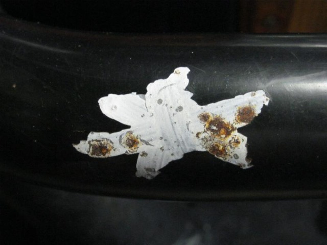

Why not just get the chassis powder coated? Having said that, there’s some good paint products around these days.

Paul, I've powder coated a couple of items in the past, and to be honest not a fan if the item is exposed to chipping, etc this is primarily a result of a poor application by the firm, it can either be over-cured or under cured. I like paint because it's easy to touch up and a fraction of the cost.
And you can do it your self , the down side is you have noone to blame aster the fact.

I had the chassis from a Triumph GT6 galvanized by a company in Birmingham and that turned out fine. Maybe it was the deep tank that enabled the chassis to go in vertically.
If you screw in a bolt and then galvanize you can heat the bolt head until the zinc melts and then remove the sacrificial bolt and jobs done.
Roger
So really skilled people out there who take pride in their profession , I think preheating the chassis is a key to a perfect coating.

there is powder coating and there is powder coating.. and of course big differences in galvanizing as well. See what products the company makes and if it is for coastal and outdoor use. A local company here has a 25 years rust warranty on their galvanized and coated products and I am 51 and seen it for the last 30 years so I know it is good.
If you send stuff off to be powder coating, do take great care in removing burrs and sharp edges as this is the first place the coating slips.
typically not great on US products with poor powder coating.
