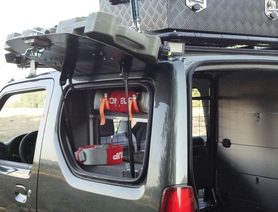

by JBradders
Replied by JBradders on topic What did you do to your jimny today?
Not today, but a couple of weeks ago I added a game rack across the rear seatbelt mounts, and a shelf to the back door.....
Nothing fancy but I just joined the forum and thought I'd better post *something*.
[hr]
I'm planning on doing something like this on the driver's side...
As it seems like it'll create quite a decent sized storage compartment that can be easily accessed. It'll be above the wheel arch so won't really affect boot space at all.
Has anyone done anything similar? How easy is the rear window to remove without breaking? (I'm guessing the usual bike brake cable trick will do the job)
I'm thinking of reusing the existing window glass and bonding the hinges & latch directly to it so that from the outside it looks totally standard.
...Might not make a start on this till spring though in case it takes longer than expected and I have to spend any time driving about with a missing rear quarter glass.
