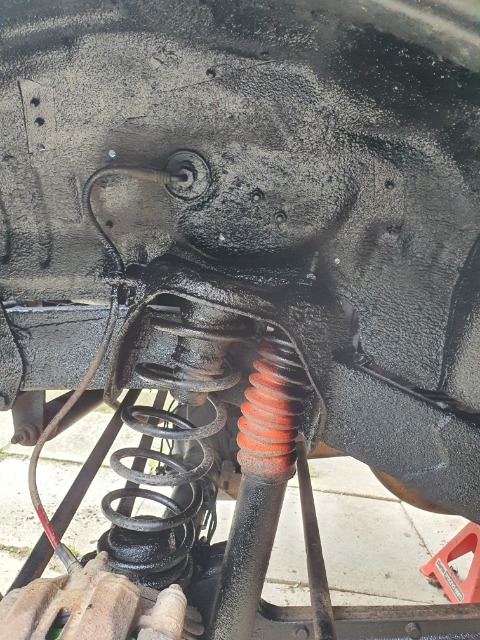

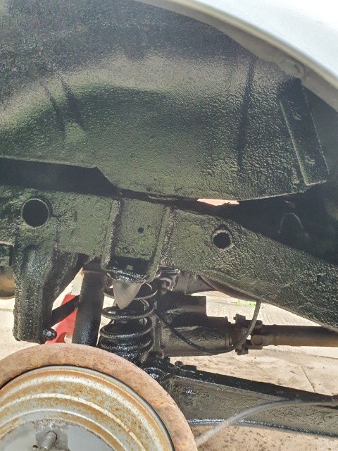

Having a compressor and stands I do my own. I use waxoyl because I started with it when Dreadnaught was new,literally the first thing off the forecourt. So having started I will finish. The thing is that the prep is the biggest task, removing loose anything and touch in any open rust with conversion and paint then I waxoyl but that's quick. When I started there wasn't any cheaper coating like buzzweld are now.

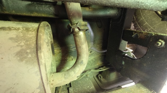

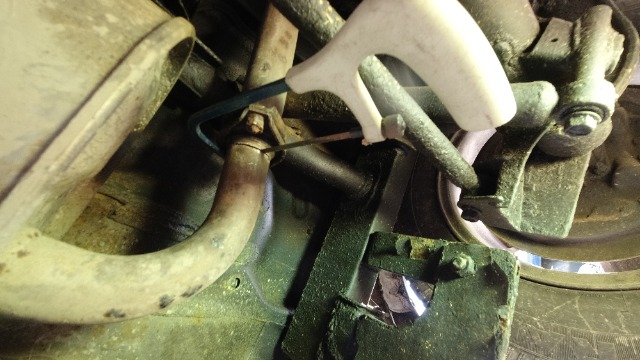

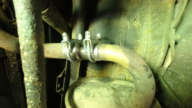

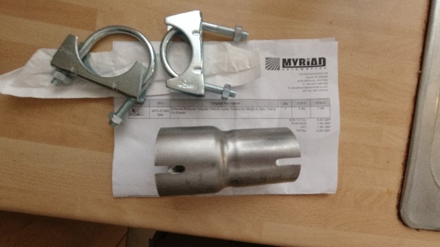

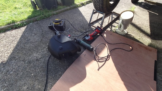

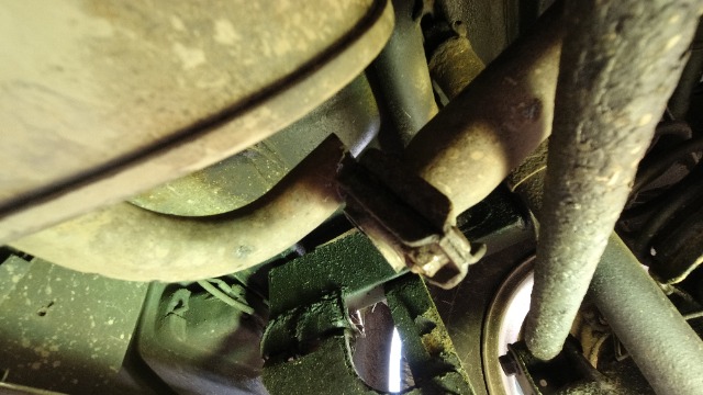

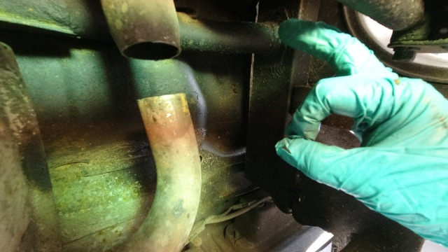

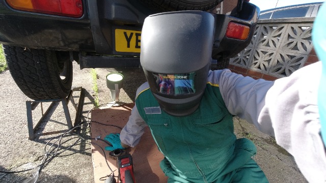

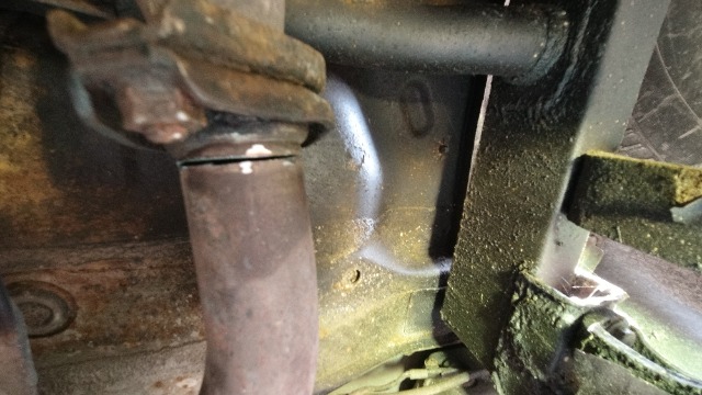

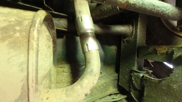

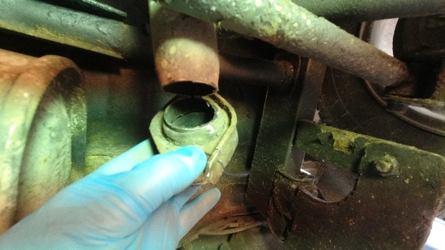

Back box joint blew out (Don't forget the paste)
The tale is told over a couple of days but goes like this....
I could not get the nuts undone, even though I soaked them straight away for 24 hours,seized solid and had corroded smaller of time.
A 16mm socket rounded the nut and a 15mm would not go on at all! Captive bolts didn't help either..
My other option was to get a new back box and joining pipe to the Cat, but I would have struggled doing that on my drive so,
out with my new cordless grinder..
and then the hacksaw
Halfway there...
Done.
I had already ordered a custom made reducer (50mm to 42 mm)
Confession: I didn't put jointing paste on and, after tightening up it was blowing slightly, so went to my local 'dealer' and
got a tube of 'Klarius' jointing paste, so off it all came and liberally applied a generous amount (it was only the joining pipe side that was passing, not the back box side!)
Let it run for 10-15 mins per instructions and took it round the block.
Sorted! Was pleasantly knackered after though..
Cheers
Gaz

I remember helping my brother Waxoyl his MG about 35 years ago, it was a horrible job, so when my local garage said they did it I jumped at the chance. Apart from anything else I don’t have a garage big enough to get my Jimny in and the local garage charged me £120 which sounds quite good to me.
I wish I had more space and the time to do jobs like this myself, but I don’t and the misses wouldn’t thank me for coating the drive in Waxoyl.
Why Waxoyl, I know it from old and my mechanic friend swears by it. Apparently Drintol is the other front runner, used by the army, so it must be good.
