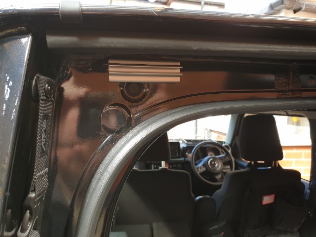

Today I made a mini awning for the rear door. All from off cuts left over from my big awning.
Awning C-section stuck in place with 3M double sided tape.

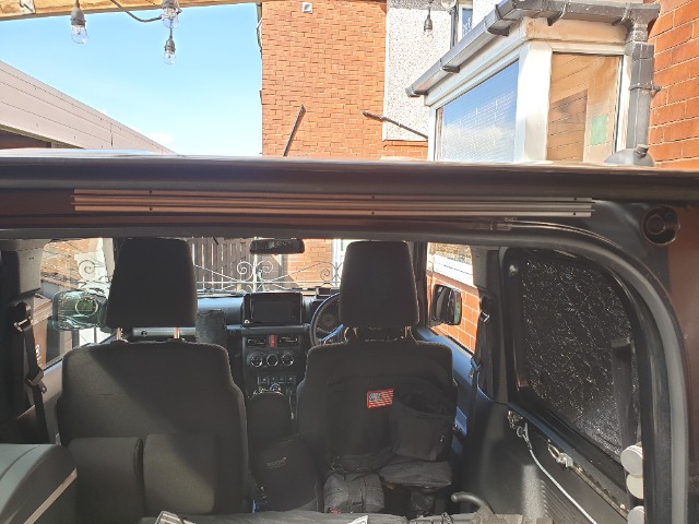

Purposely left a gap, then stuck the longer piece in place.

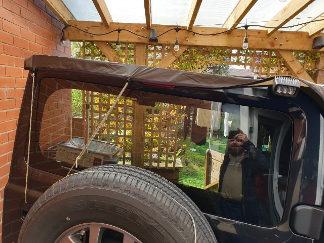

Some Tarp Clips on the edge to hold in place and cord looped under the door handle.

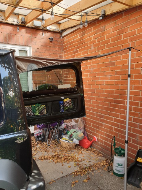

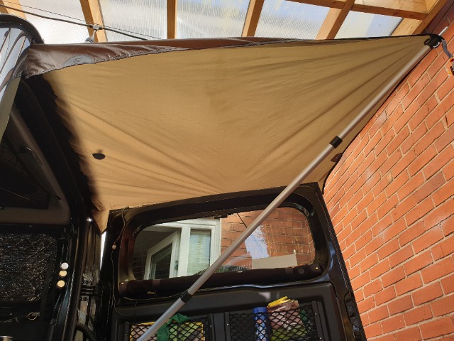

Just one pole needed

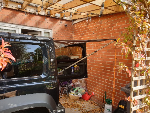

If there is nowhere to get a peg in the ground for the guy line, I could use it like this. It's not in the way if sat on the edge of the boot.
