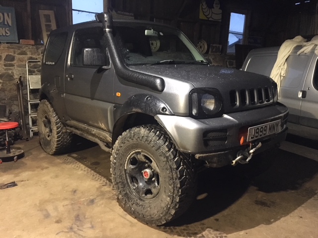

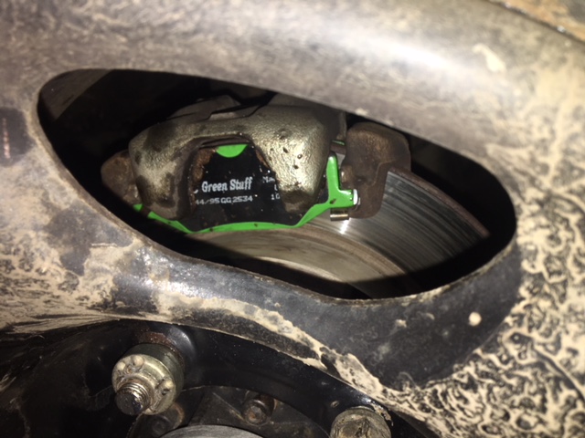

Fitted some wheel spacers to stop the huge tyres catching on the chassis rails, radius arms and exhaust. Worked for all that, but now I need to trim more from the arches (again! :laugh: )
and while the wheels were off some new brake pads. EBC greeenstuff as they have been getting good reviews from everyone...

LOL its growing into a monster truck :ohmy:

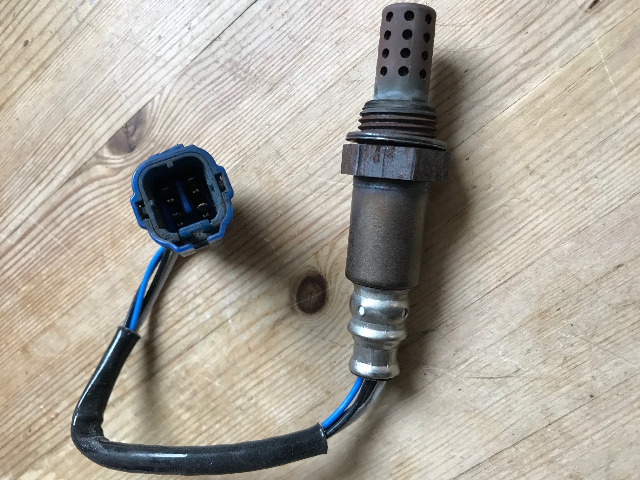

Thanks to another BigJimny member, I found a replacement O2 sensor for reasonable money from
Sparkplugs UK
which I fitted today.
I'm not yet sure if this is the offending article that keeps putting my eng' management light on, but it's a start.
For anyone else with a VVT M13A vehicle, this is a DENSO DOX-0354 Lambda/Oxygen Sensor
£65 from Sparklplugs UK.
Fitting it req'd a Lambda socket which luckily I already had, but which can be found in places such as Halfrauds for a small fee.
I was worried about loosening the old one. but it gave up easily when I put a spanner on the hex at the top of the socket and gave it a small but firm clout with a lead-shot-filled hammer.
New one torqued to 29.5 lbf.ft
(354. lbf.in) (40. Nm) (three white knuckles :laugh: )
