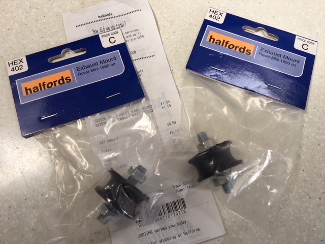

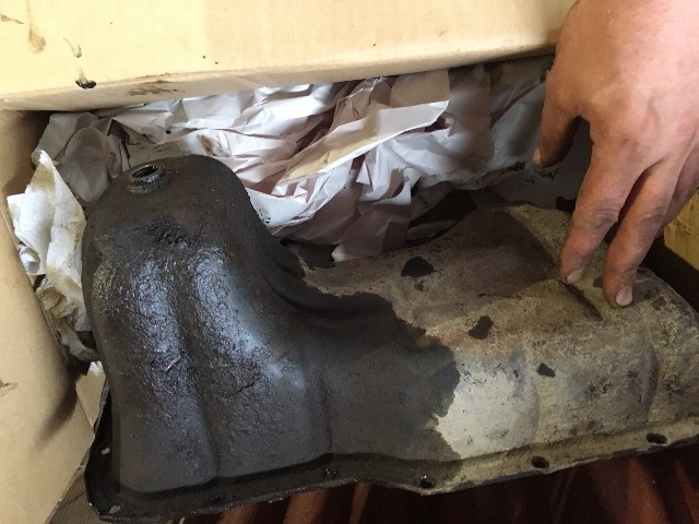

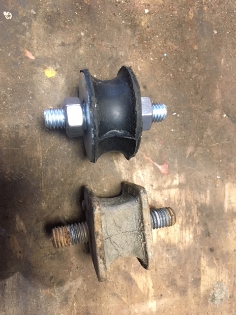

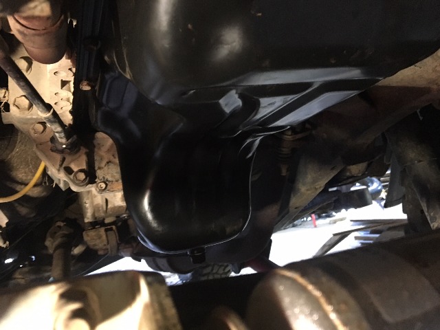

17 Jul 2018 16:29 #194394
Replied by Riccy on topic What did you do to your jimny today
Replaced the oil pan, gone porous and leaking a little
Messy job but had to be done. Easy on J999MNY as theres 4.5" spring and 2" body lifts. Only thing that came off was the oil pan itself to do the swap
Then onto some bushings on the gearstick that have been annoying me for a while. A recent post by Michael-c about them prompted me to copy him and get some for a mini today. They go in with the intermediate prop unbolted from the t-box easily, as he says, and make a huge difference to the gear selection.

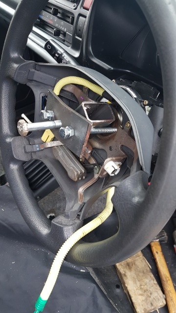

04 Aug 2018 13:45 #194824
by ahtr
My green laner build
2003 Jimny - M16 engine - 4.16 TC - Winch - Snorkel - 30x9.5 Maxxis MT-764 tyres on 15x7 ET-7 offset wheels - 4" lift - Rear floating axles and discs
Replied by ahtr on topic What did you do to your jimny today
Had a battle with the steering wheel. Airbag light had come on and horn stopped working, so replaced the squib behind the wheel with 2nd hand one.
Wheel put up a solid fight, bit of a rough puller knocked up and wound a load of tension in it, then a bfh and a block of wood on the back of the wheel eventually did the trick
Airbag light cleared and horn working again!
