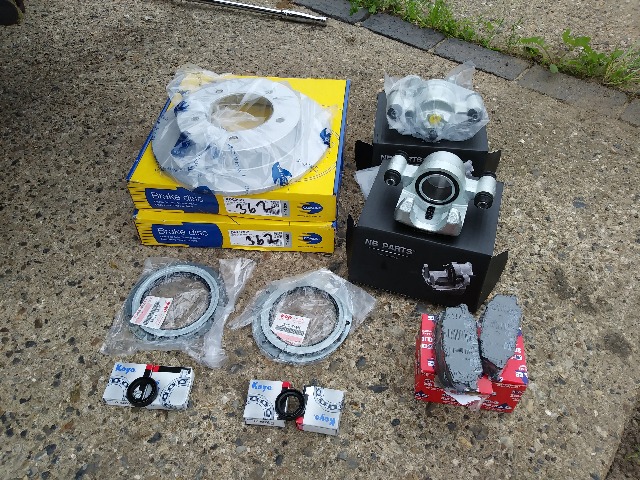

10 Jun 2018 21:23 #193359
by 1390_taz
Replied by 1390_taz on topic What did you do to your jimny today
