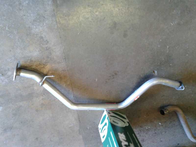

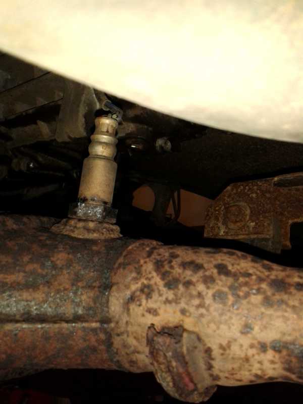

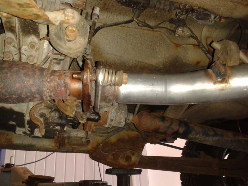

new rear pipe section fitted
but the inlet pipe to the cat also needed welding up as a temp fix ..... will need a cat at some future date, any recommendations, believe the O2 sensor usualyy dies on removal too ?

by Halford
looking like £135 for Cat pipe and sensor delivered, could be worse :pinch:
S/S too expensive ....
but did have problem fitting the new pipe to my S/S rear box as the new replacement pipes have a slightly larger dia than the OEM pipes, hence it wouldn't "slide-into" the rear box pipe for clamping. The solution was to weld a section of "good" old pipe to the new pipe for the "good" old pipe to slide into the rear-box pipe ..... hope that makes sense, I know what I mean anyway :lol:
