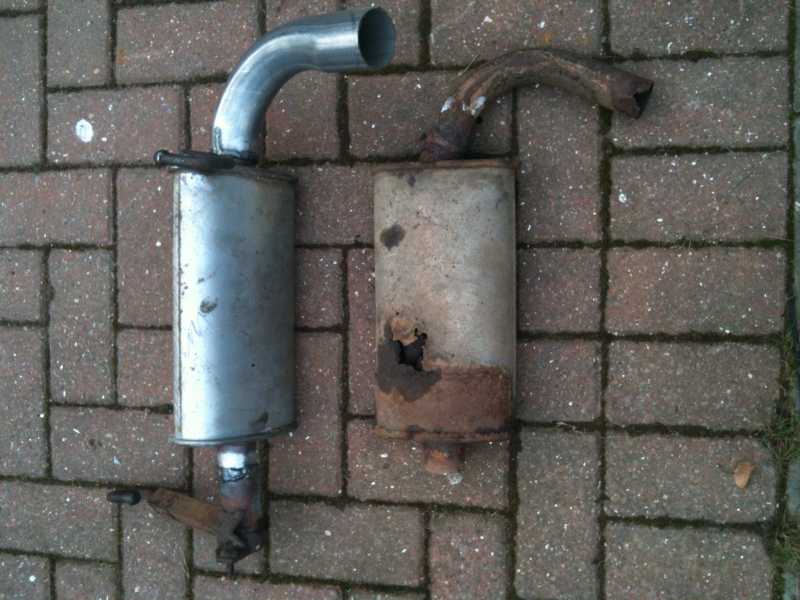

Fitted new Exedey clutch on Friday, welded both brackets back onto the front section of the exhaust on Saturday and rebuilt the back box Today, just needs son UHT paint on the welds to slow the rust. I think I'll drill a hole in the bottom of the box as the old one was full of water.
