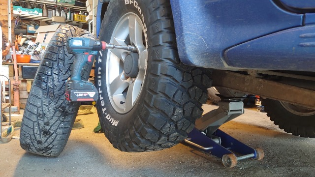

01 Apr 2022 13:59 #242663
Removing boring rubbers for the winter, embracing the spring, putting the fun loafers on it.
Love how you can Jack it up first the front and then the back not needing to Jack up four times
And yes Lambert, probably inviting my slight wobble back..
