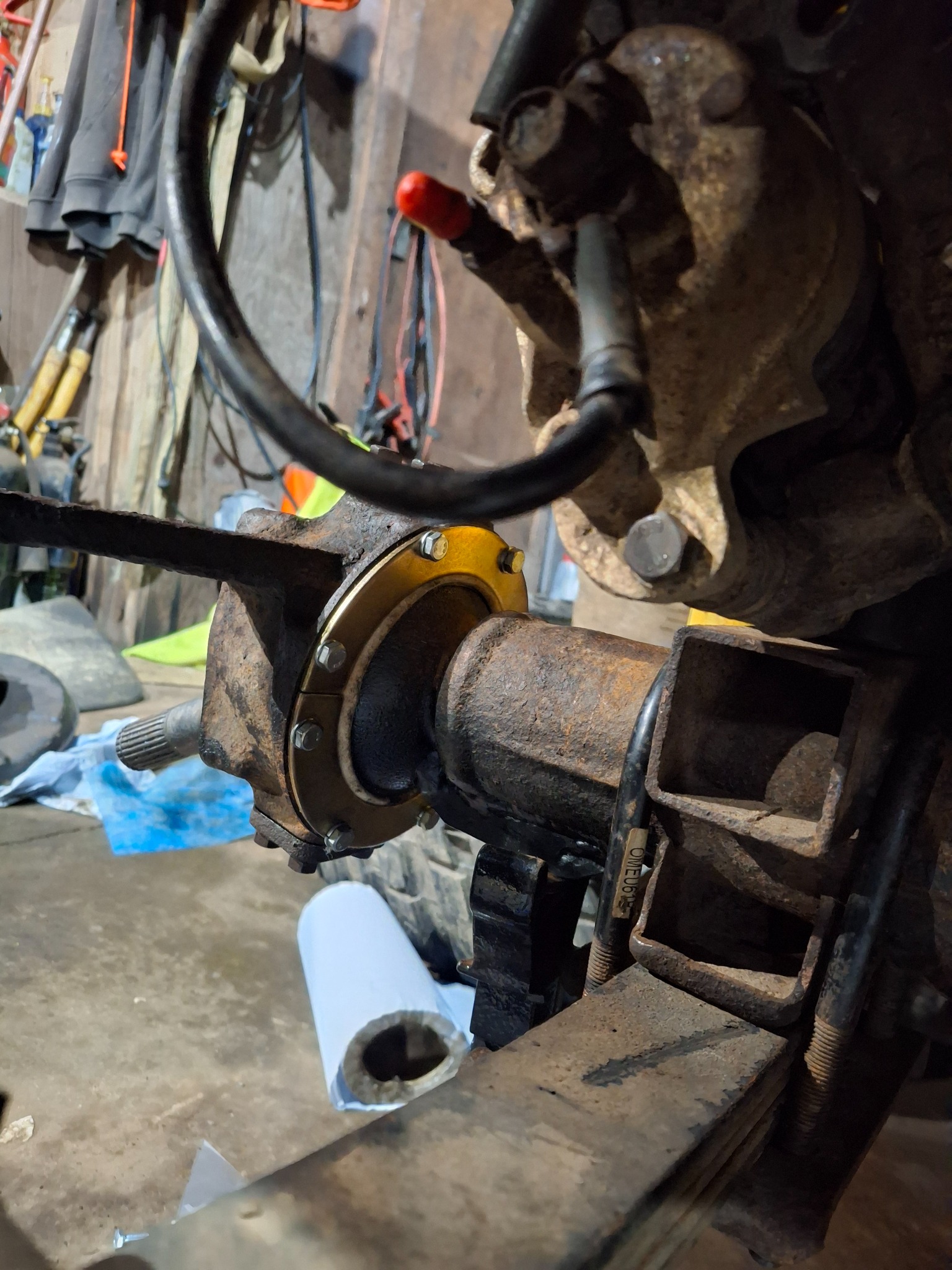

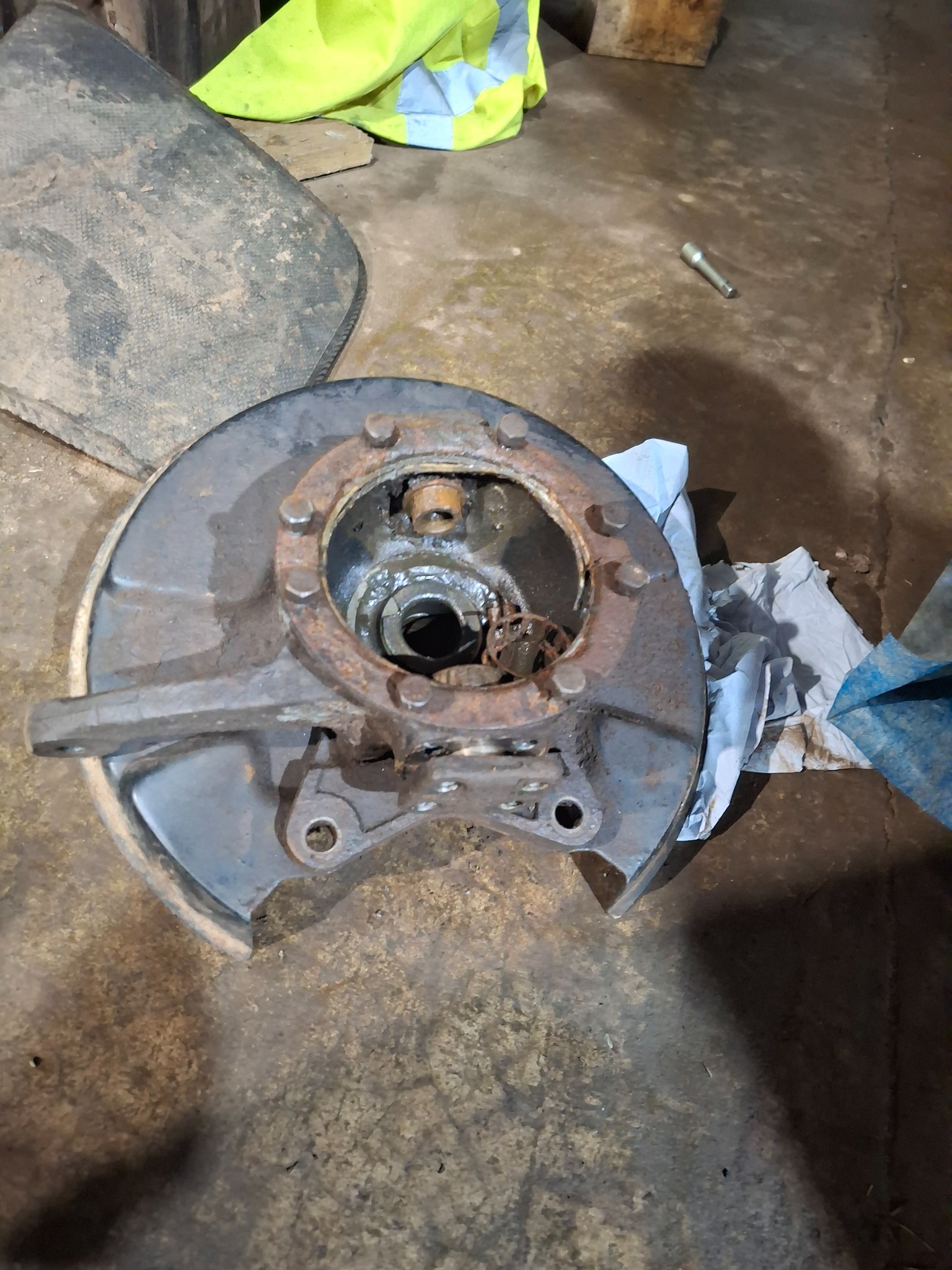

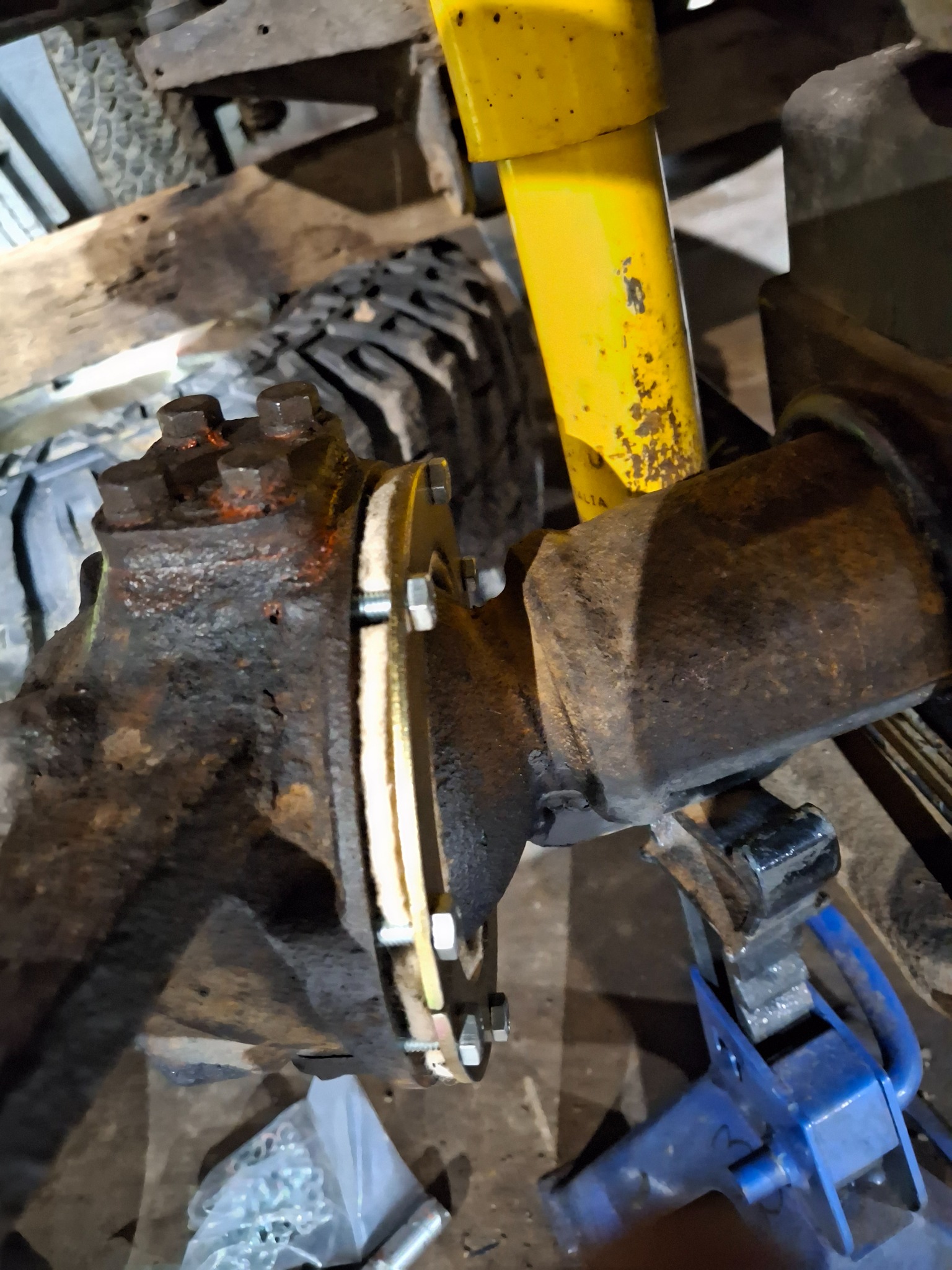

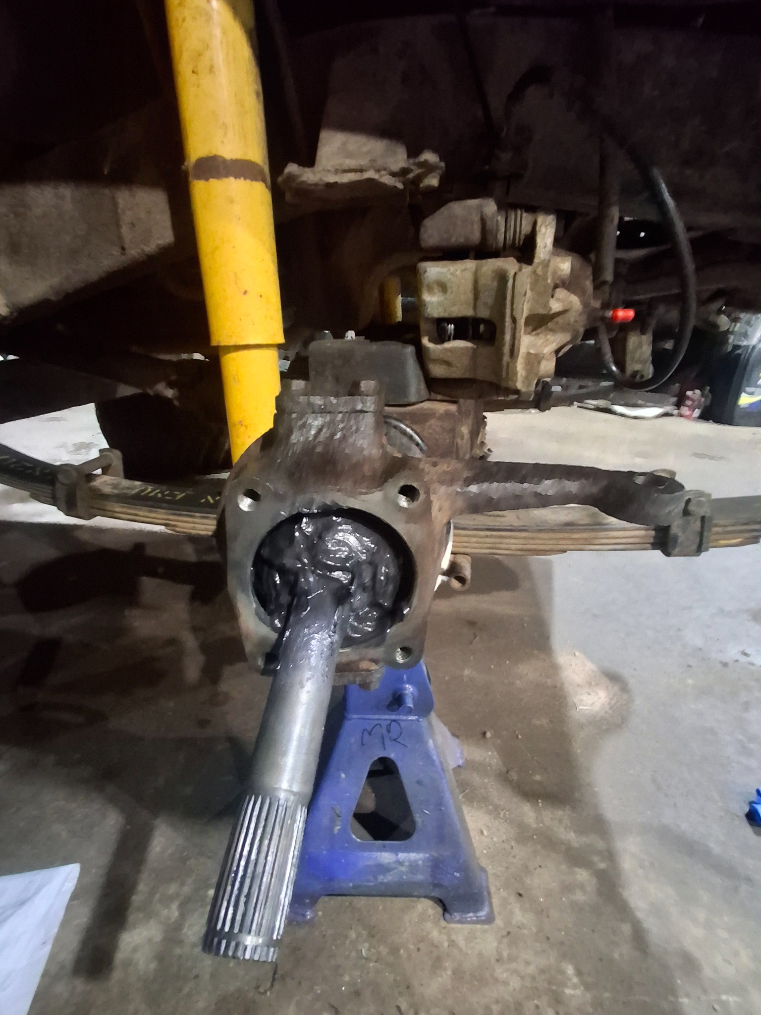

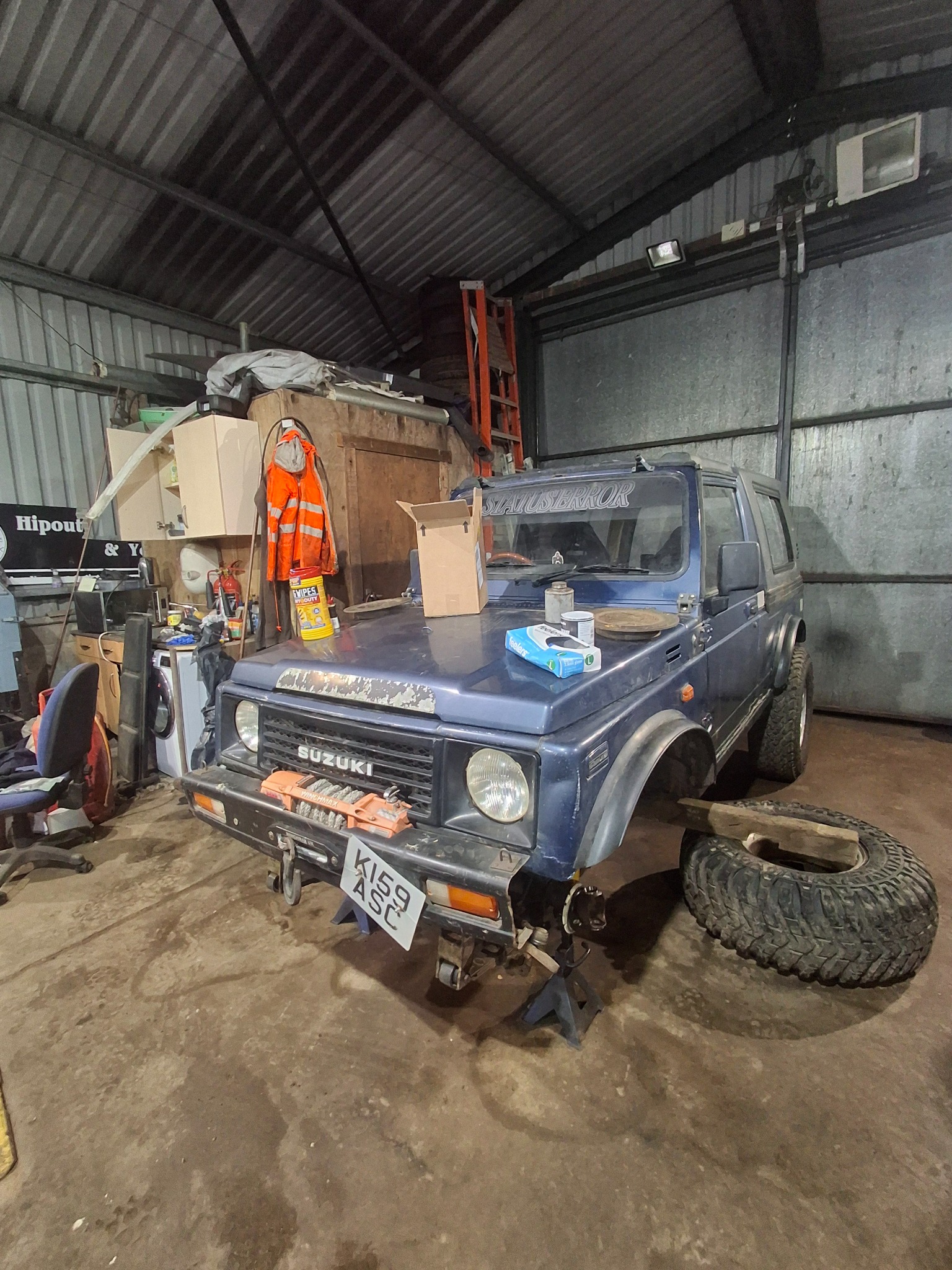

Couple hours in the garage tonight, got the drivers side reassembly started. Re-greased and fitted front shafts, fitted new kingpin bearings with the old kingpin and shims and got the preloaded set to 4lbs. Handy luggage scales. Had to steal some bolts from a set of spare hubs. But that's why we hoard parts.  Got the busted knuckle seal kit from trail gearBolted up. Had to start the bolts without the spring washers to get them on but there all on and tightened down now. Little steps at a time
