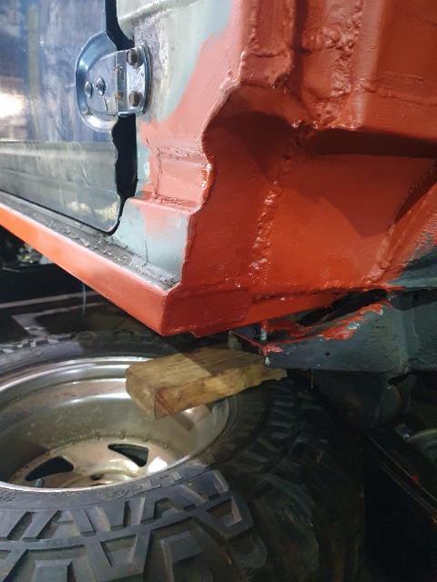

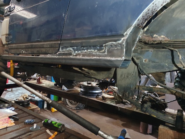

Picked up a Lwb Sj this year after wanting one for many years. Had to sell my old white one to get it but I kept most of the good parts to swap over.
So far I've fitted powersteering, rocklobster transferbox, old man emu 40mm springs and swift gti front seats.

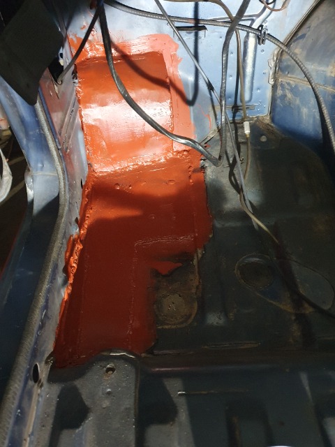

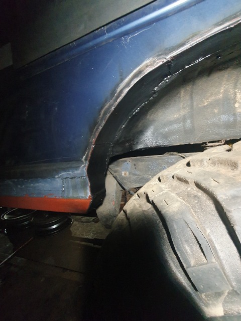

I've also finished the body side of the welding. Including fitting 100x50mm box section sills, 4 body mounts, tubbed the rear arches and bulk head.
Engine wise I have fitted a new timing belt, waterpump, leads, plugs, fluids and filters.
Next up is the front tubs, battery tray and wiring up the lights.

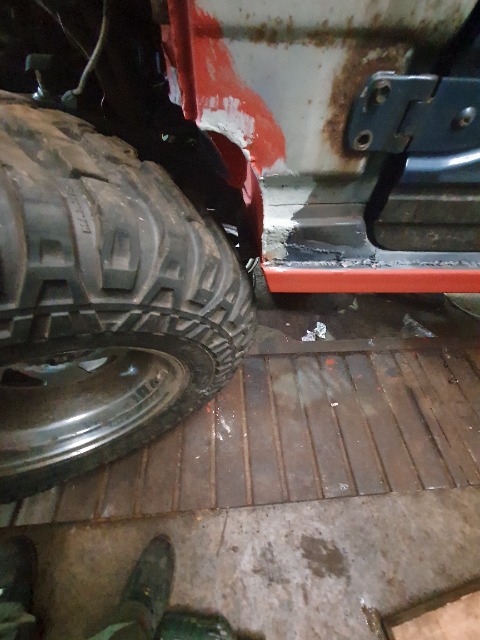

Been a while since the last update, made quite abit of progress though. Welding is complete, front end tubbed and refitted.

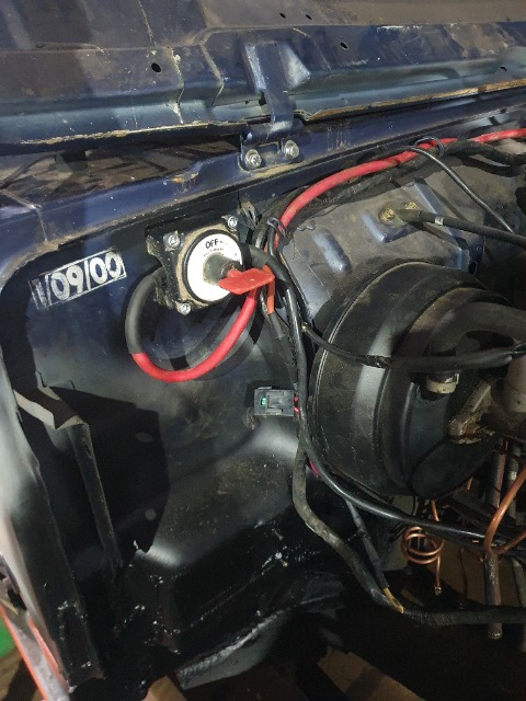

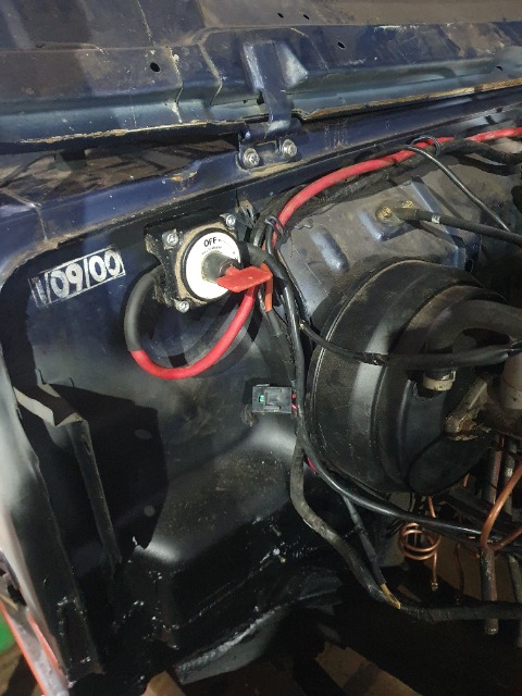

Got the battery fitted, and winch wired up. Relocated the battery to the passenger side with the winch solenoid and ran my controls to the dash.
Got all the front lights and Indicators fitted. Just Tails and fog then that will be lighting done.

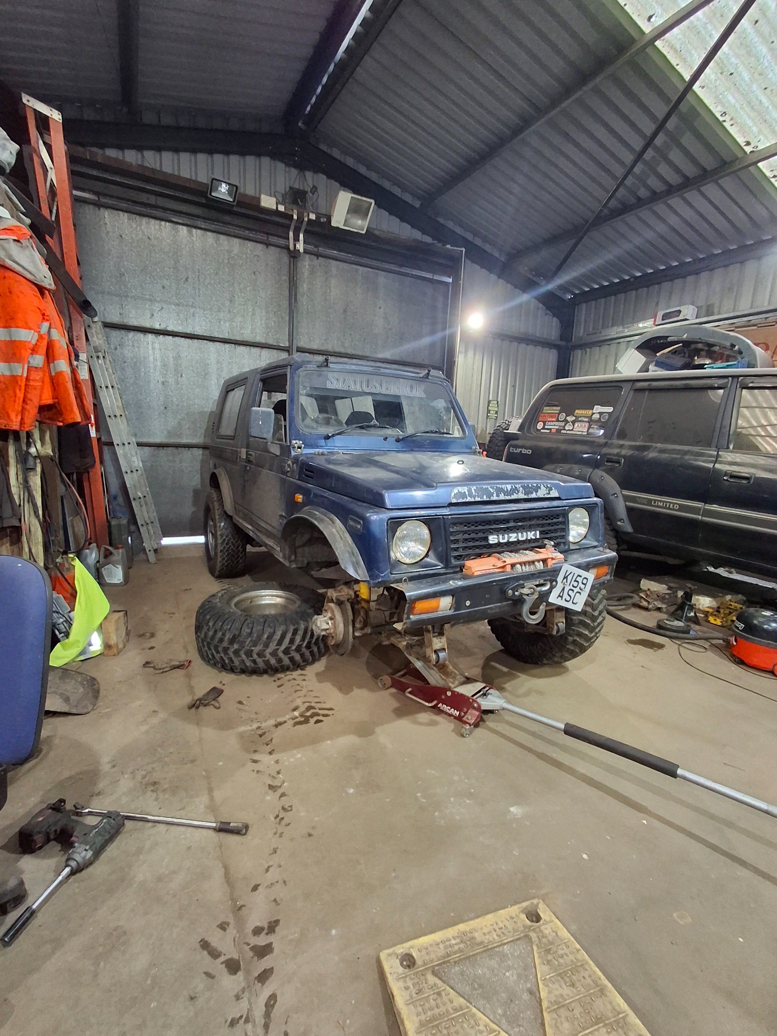

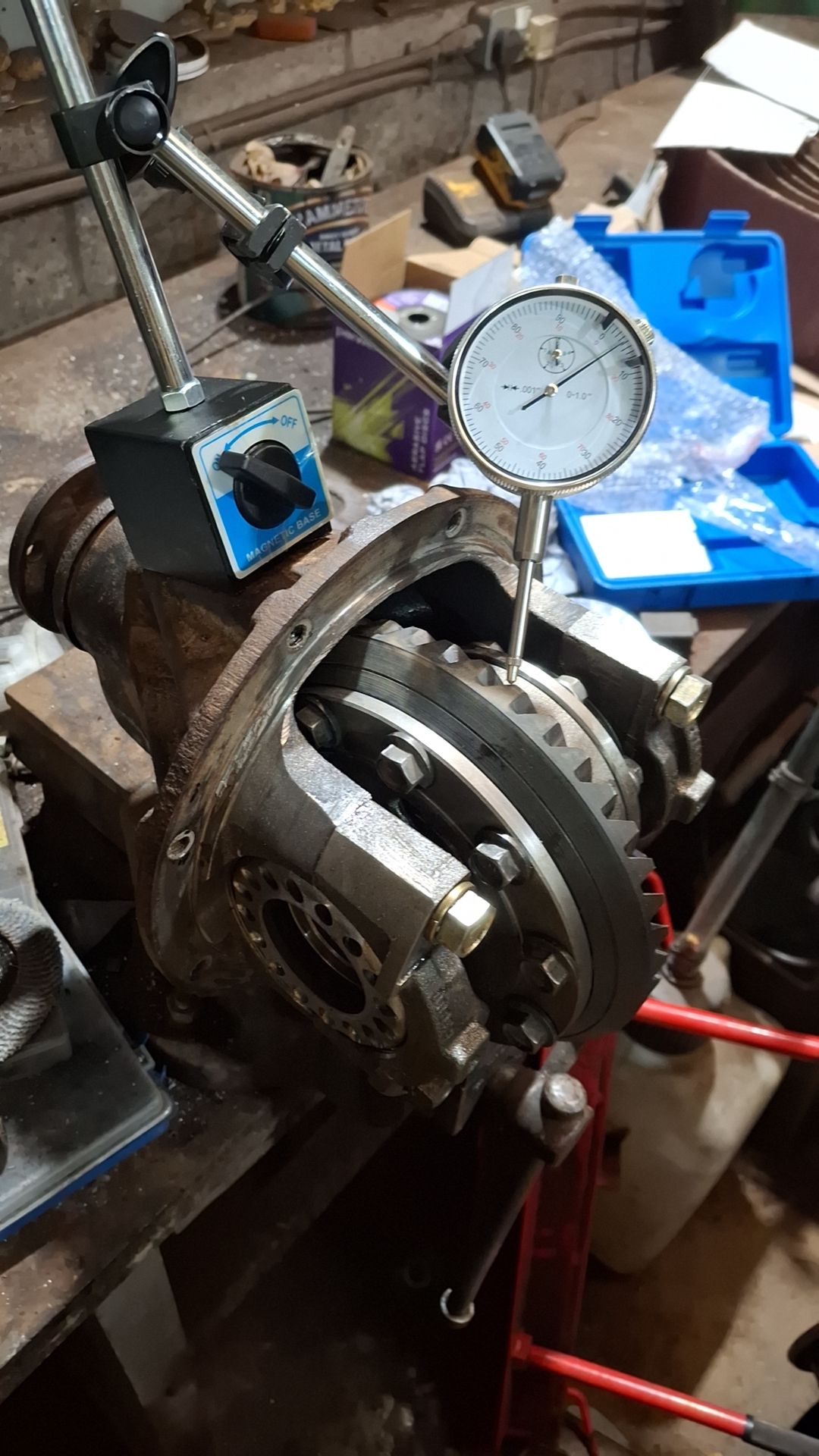

Been a while since I updated but im doing a bunch of work now as ill be bringing this to big jimny 26. In the middle of rebuilding the front end hopefully will have it finished tomorrow then ill need to change the rear dif. Discovered the front and rear are different ratios today
