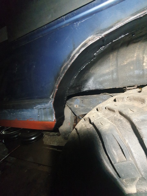

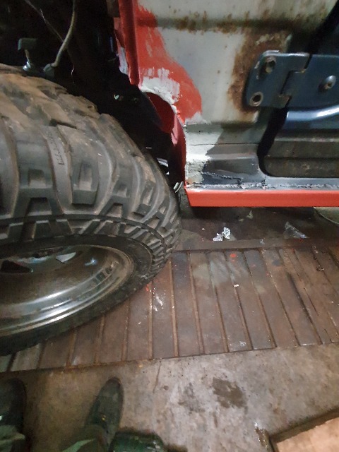

I've also finished the body side of the welding. Including fitting 100x50mm box section sills, 4 body mounts, tubbed the rear arches and bulk head.

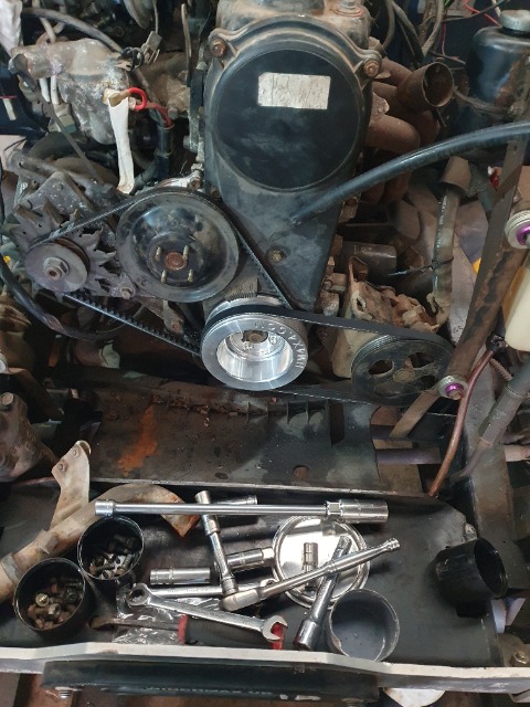

Engine wise I have fitted a new timing belt, waterpump, leads, plugs, fluids and filters.

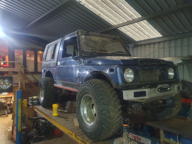

Tyre size? 36"?
Tyre size? 36"?

Thank you! I've been trying to get a good run at it, and there 33x13.50s

Been a while since I updated but im doing a bunch of work now as ill be bringing this to big jimny 26. In the middle of rebuilding the front end hopefully will have it finished tomorrow then ill need to change the rear dif. Discovered the front and rear are different ratios today
