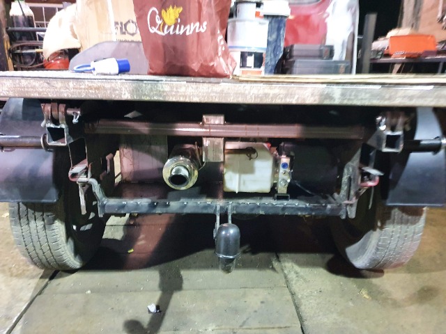

09 Jul 2023 07:25 #249790 by cwhelan
Replied by cwhelan on topic @jimnygoat project

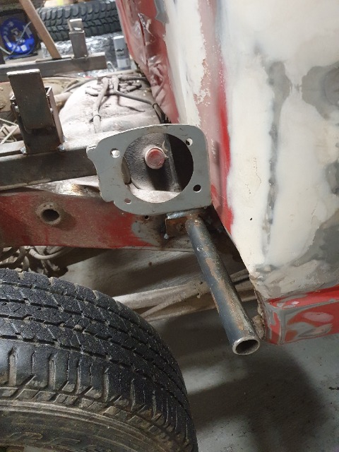

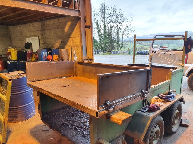

removed the standard back box and added in a motorbike one, this made room for the 12v hydraulic system.
flat panel to tidy it up.
lights added

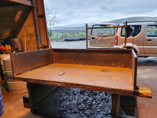

09 Jul 2023 07:26 #249791 by cwhelan

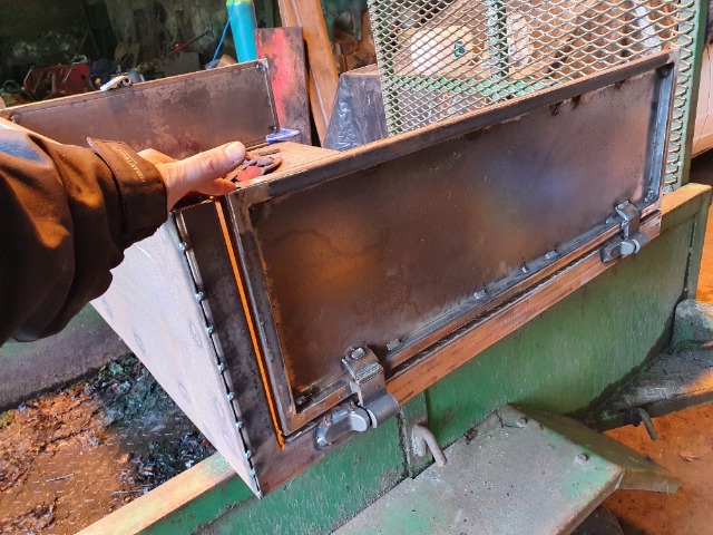

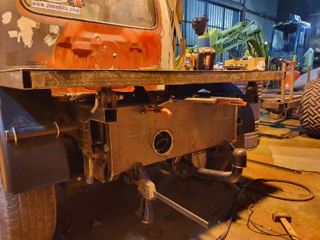

filler neck welded on

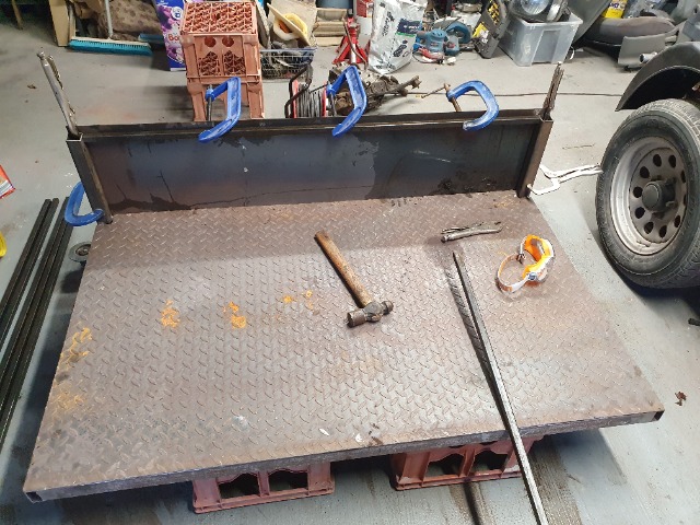

09 Jul 2023 07:29 #249792 by cwhelan

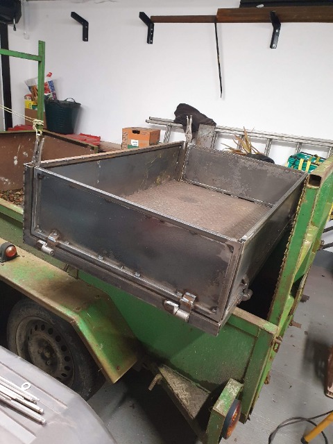

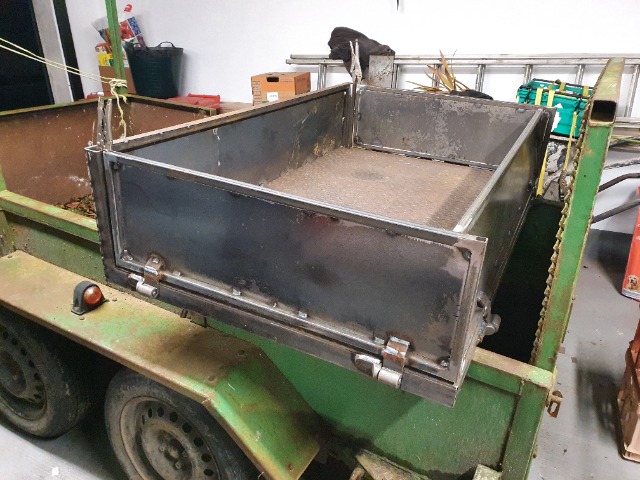

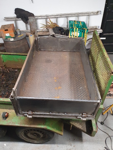

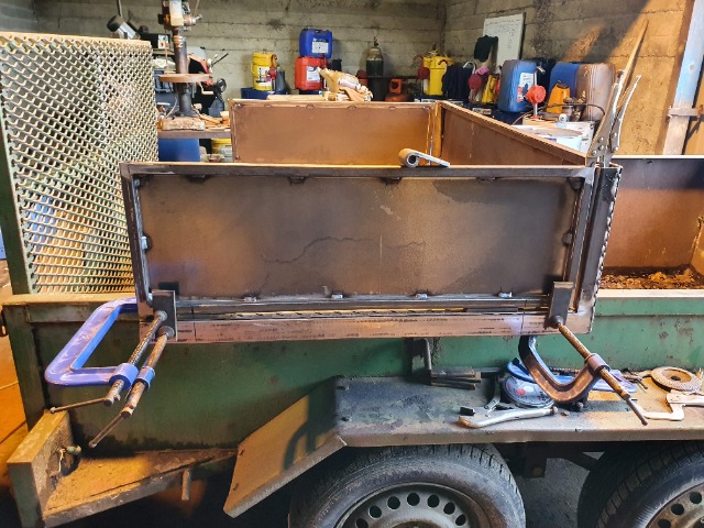

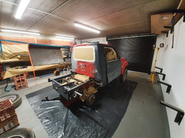

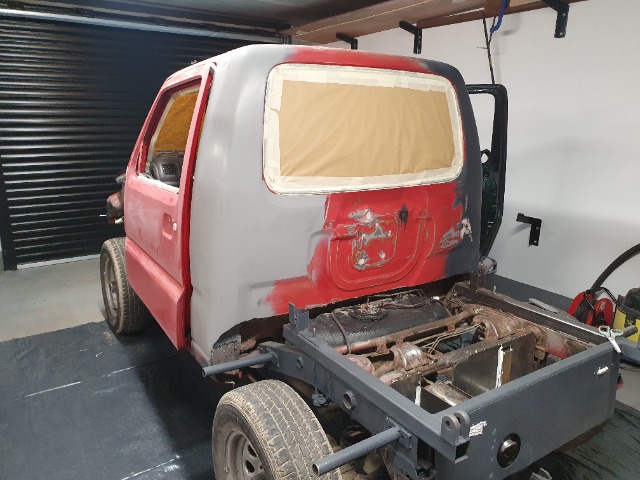

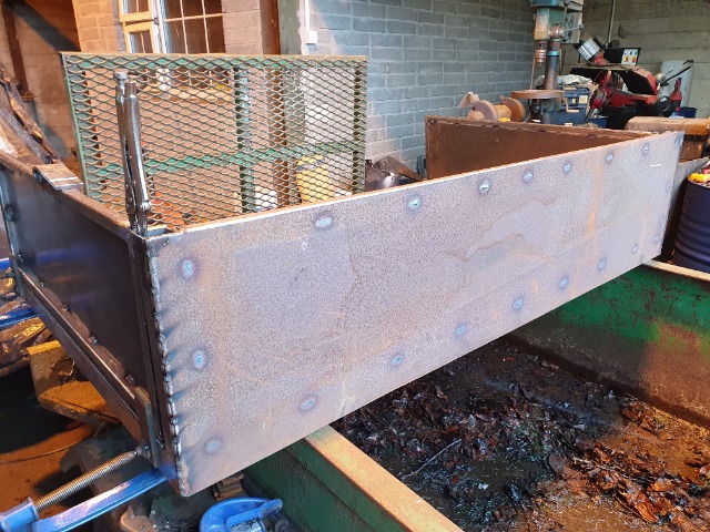

rear tray and sides welded up.

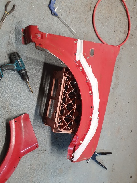

09 Jul 2023 07:31 #249793 by cwhelan

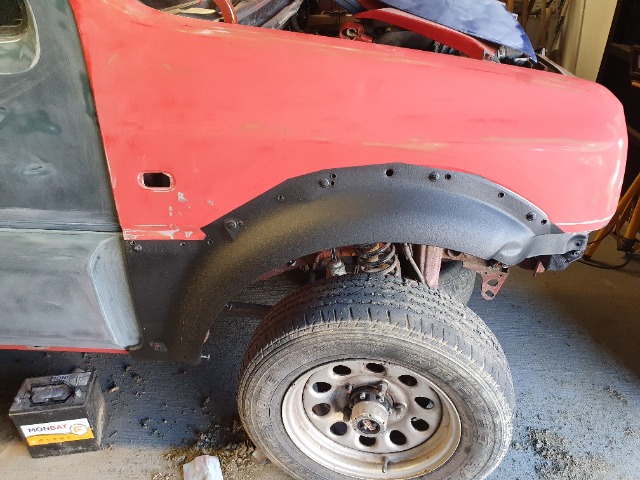

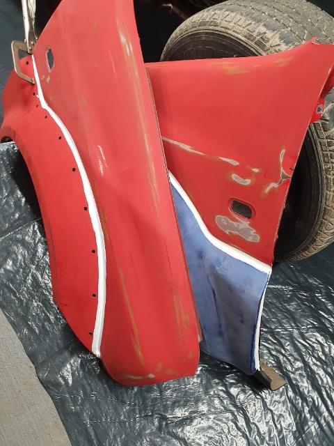

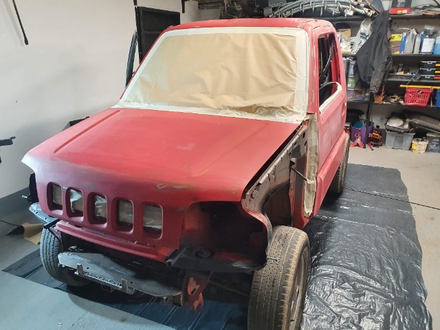

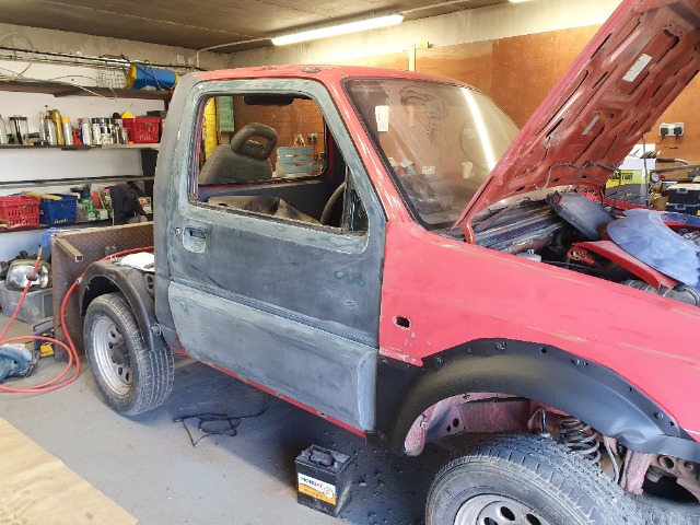

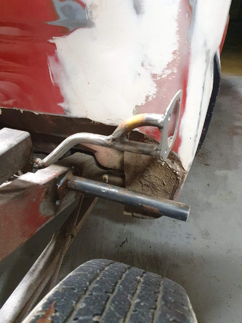

front wings cleaned up and sprayed behind plastic arches, plastic arches stuck onto wings and ready for paint

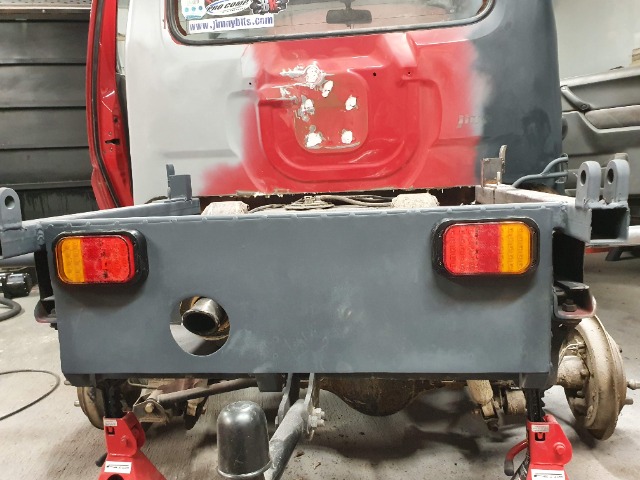

10 Jul 2023 07:09 #249799 by cwhelan

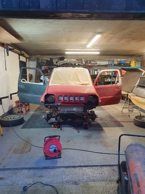

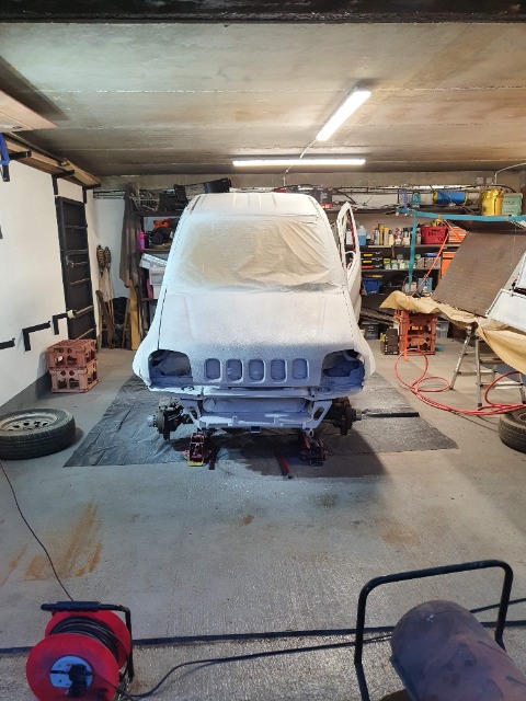

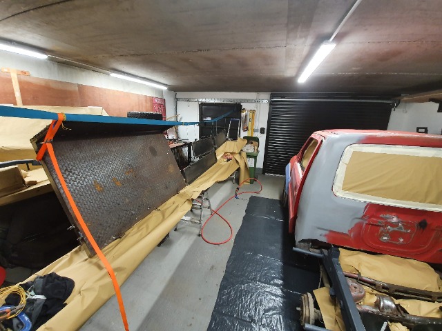

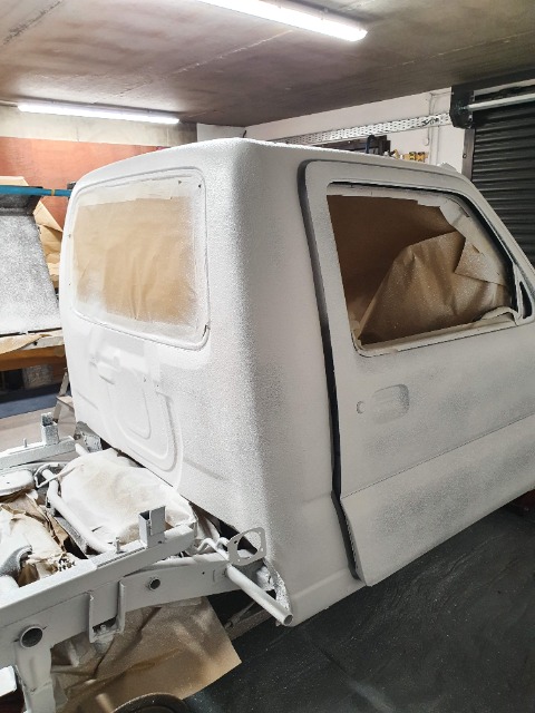

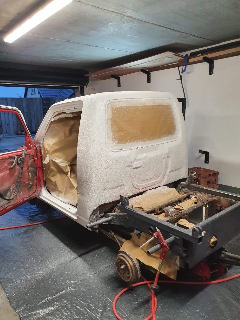

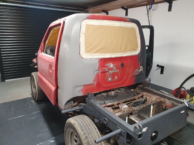

getting ready for paint, follow along on instagram if you like @jimnygoat

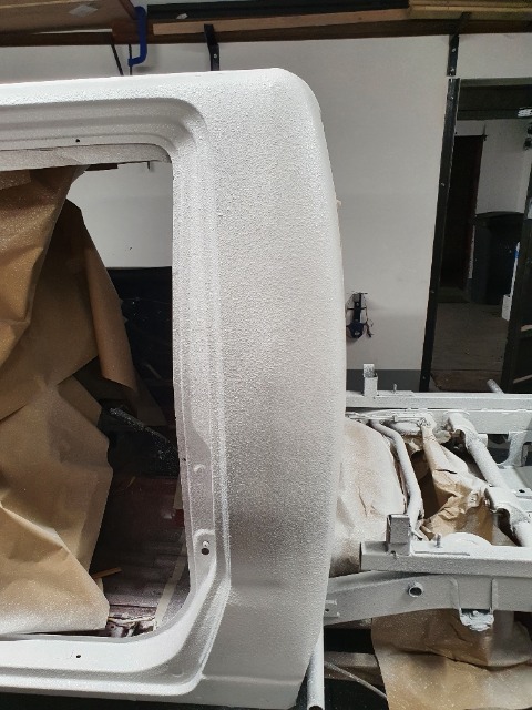

10 Jul 2023 09:20 #249801 by cwhelan

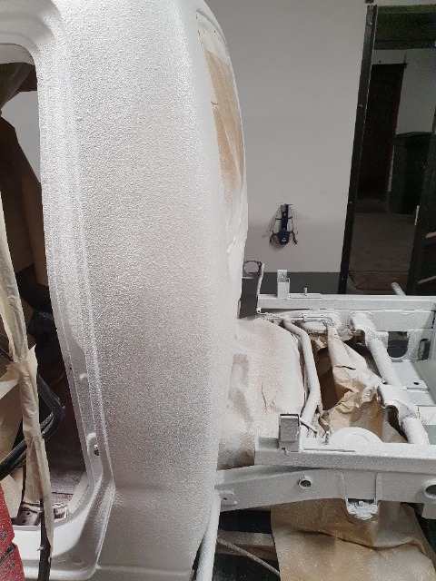

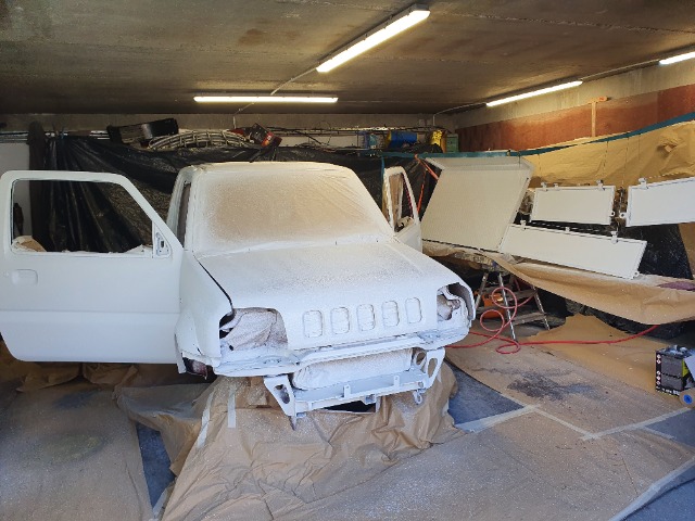

jimnygoat all painted in white raptor paint, bit of a learning curve with raptor paint, texture is alot bumpier than I hoped for, would recommend buying the official gun to get your desired finish.
