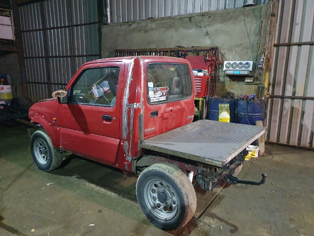

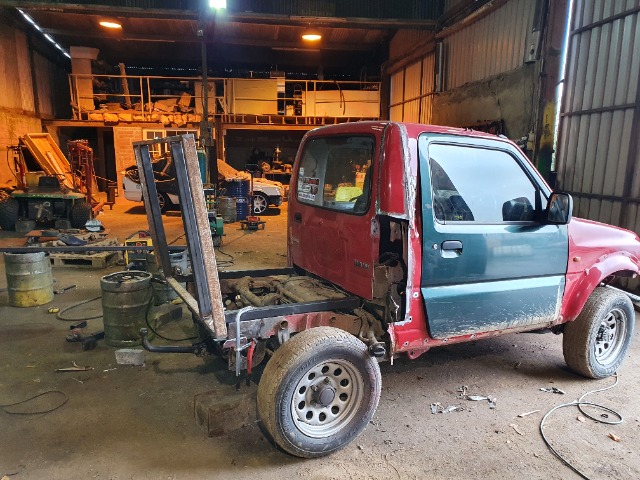

started work on the rear bed/tipper
chequered steel added as flooring.
10 Mar 2023 14:22 #248012 by DrRobin
Replied by DrRobin on topic @jimnygoat project
That is a good idea to use the rear door as the back of the cab.
I did wonder if you might have kept it as an opening door, but I see you have welded it shut.

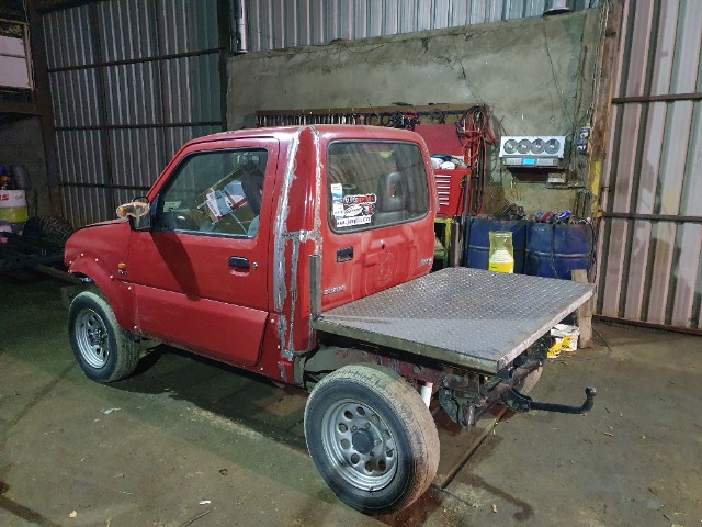

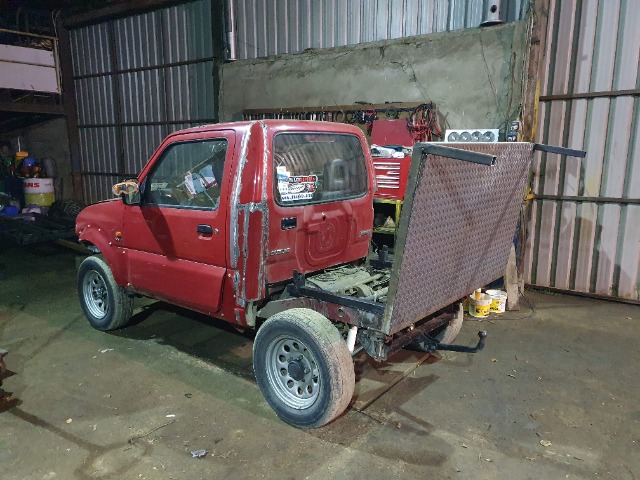

18 Mar 2023 16:28 #248087 by cwhelan
Replied by cwhelan on topic @jimnygoat project

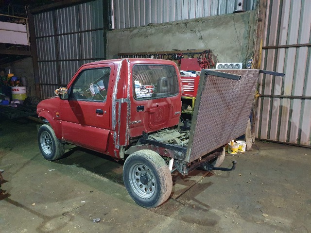

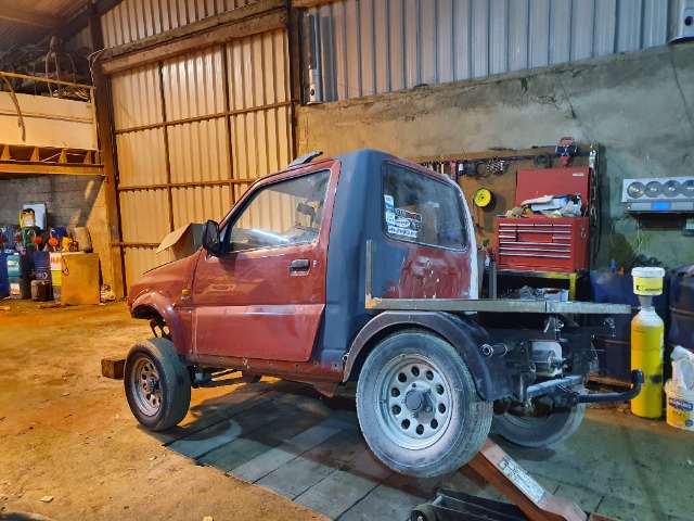

floor added to the tray

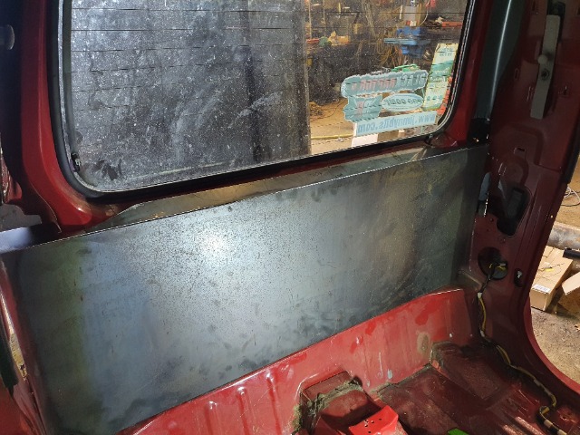

tipper body
made a start on the inner bulkhead

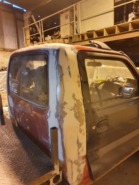

18 Mar 2023 16:31 #248088 by cwhelan

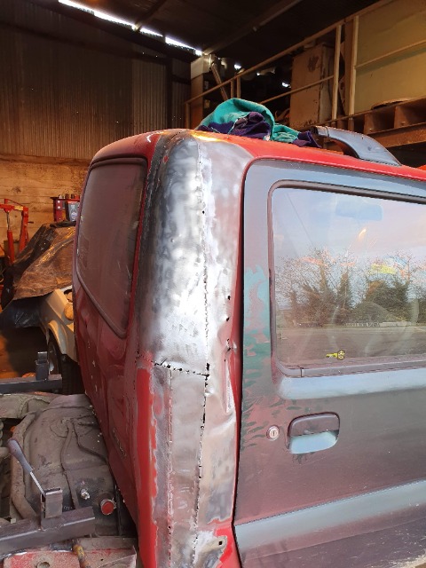

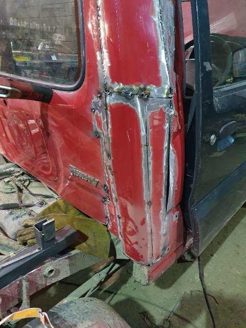

finishing the bodywork on the drivers side, this took a shameful amount of filler!!

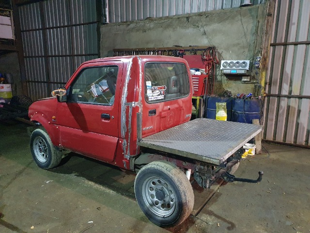

26 Apr 2023 13:29 #248844 by cwhelan

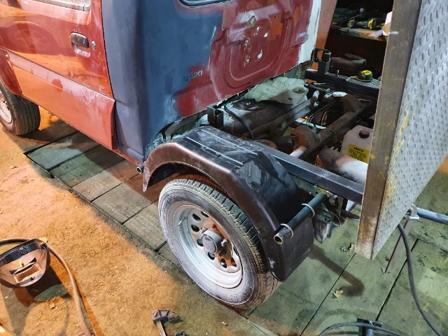

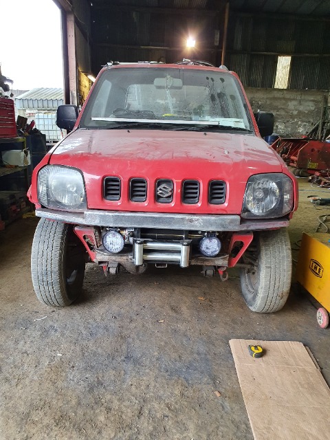

mudguards off a trailer fitted up.
tight fit.

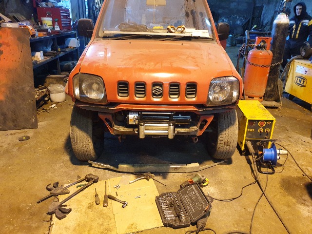

welded up a winch tray
made a bumper with 2 spot lights on it.
