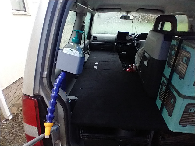

Yes, ventilation is an issue. I've slept in it a few times at home and the first night I made the mistake of keeping the windows closed. There was condensation everywhere in the morning. I had to run the heater on high for a couple of hours to dry it out a bit. With the windows cracked open the condensation is a bit less. No worries about mosquitos in this weather!

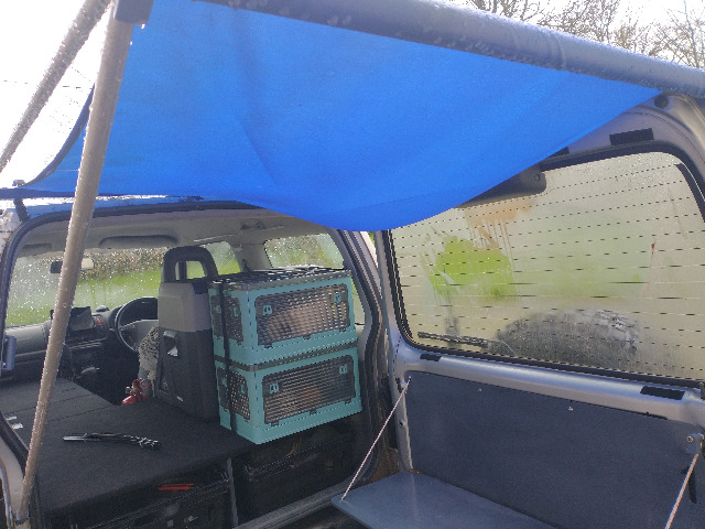

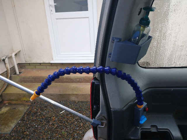

Here's a closer look at the water setup with fold out soap dispenser. These pics were taken after my first trial sleeping in it overnight at around 0C outside temperature. A lot of the water on the window is condensation. The good news is that the combination of a decent sleeping bag and 12V electric blanket kept me nice and warm even at that temperature.

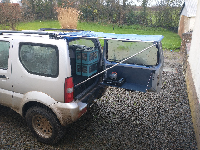

The awning works fairly well now it is properly sewn together but it is a bit low.
I do have a problem with water pooling if it rains heavily.

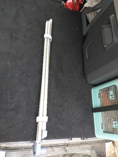

The sticks split in half and screw together. They form a compact bundle that fits nicely alongside one of the shopping totes.

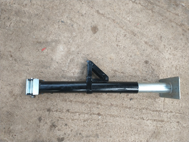

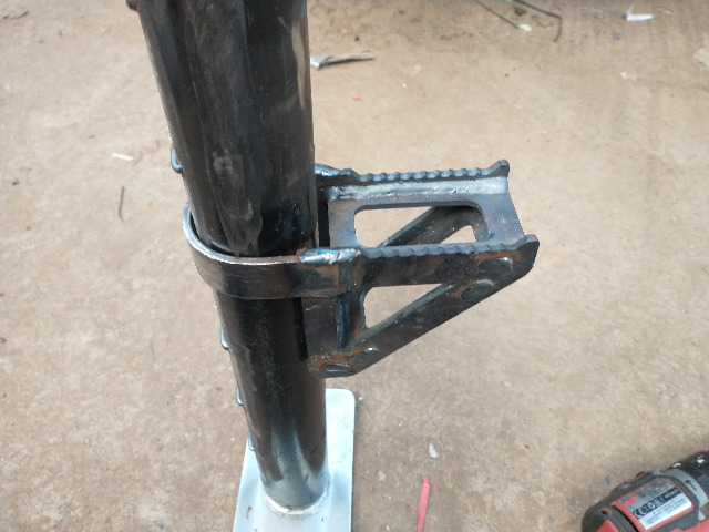

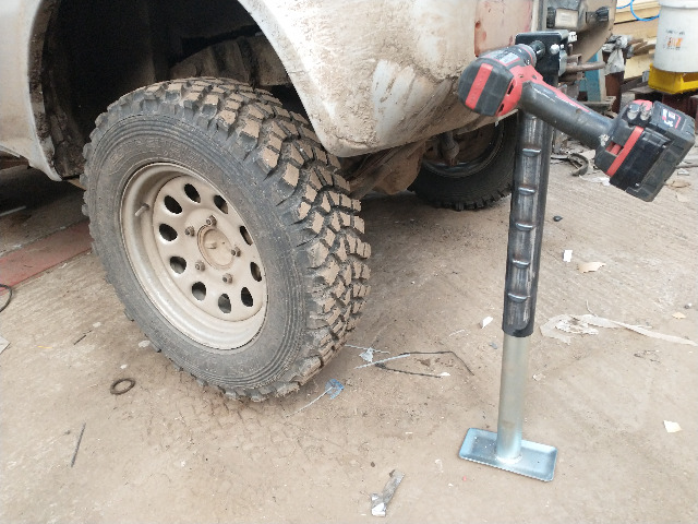

Before going out on a proper run I wanted to get the jack sorted out. Here is what I came up with. The foot can be positioned in multiple places up the jack body. Simple lines of weld stop it sliding down. The more load there is on the foot the more firmly it pulls into the body of the jack so it can't slide past the line of weld under load.
My battery drill has enough power to lift the car.

A spot of paint makes the jack a bit more presentable.

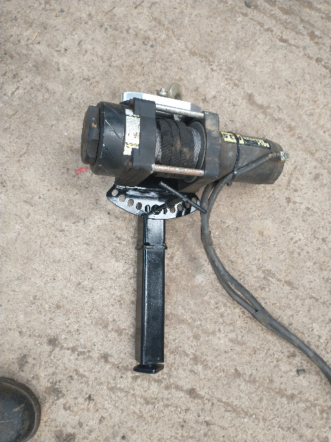

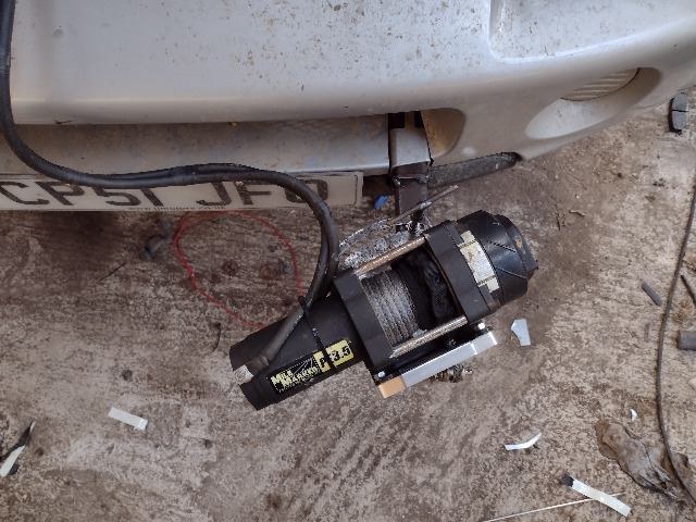

The pivoting winch mount I made some time back works well but I had problems with the angle adjuster slipping so changed the curved slot to a row of holes. That way it can't slip. Here are before and after pics
