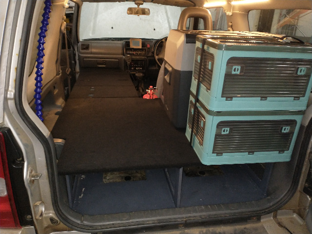

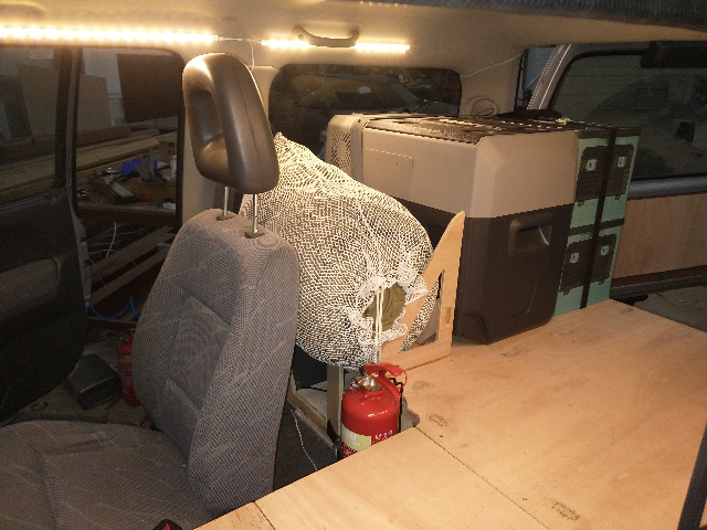

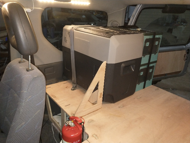

Continuing on, the fridge now has restraints so it won't hit me in the back of my head in the event of a crash. The strap is a repurposed seat belt. I removed the reel and made it a fixed length strap that goes from the top seat belt mount to the false floor. The wooden false floor assembly is bolted to the car with 6 bolts so it shouldn't move.
My sleeping bag sits nicely in the space between the fridge and driver's seat.

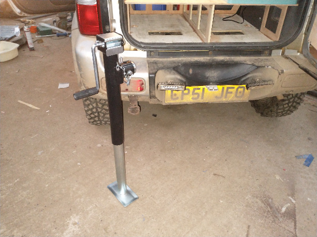

While I had the sleeping bag out I thought I'd test out the sleeping position. The old 6" inflatable mattress I have had for years is a no-go. Without the mattress it's fairly easy to get in and out of the sleeping space, with the mattress it's really cramped. Just as a reference point I tried the sleeping bag without any mattress and it wasn't nearly as uncomfortable as I expected. I think I can be pretty comfortable with a 1" or 2" sleeping mat.

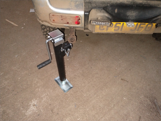

There is no where to fit a hilift jack in this setup and hilifts are rather heavy. While browsing YouTube I found this trailer jack conversion . The jack I bought weighs roughly half as much as a hilift and is rated for 2 tonnes. I need to make an adjustable toe for it but I think it should work quite well. The basic design is quite similar to the Fiat Panda 4x4 jack I use on my trials car, which works very well. The main down side I have found so far with the jack is that winding the handle is painfully slow. I'm tempted to cut the handle off and weld on a nut. That way I can wind it up and down with a battery drill or rattle gun.

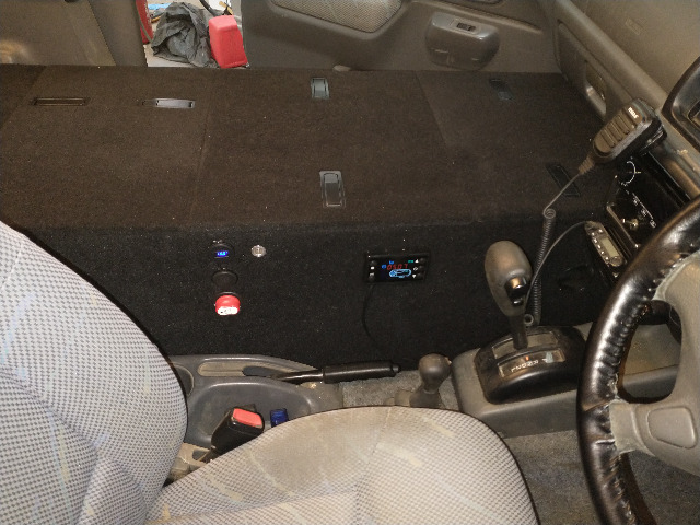

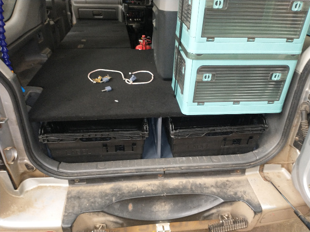

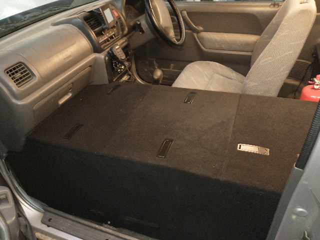

More progress - carpet makes it look a lot better. I couldn't find any car carpet in the correct grey so I went for black instead. Domestic carpet is too thick for this application.
Starting to fill up the seat compartments. The footwell is where the heavy stuff goes - winch, jack, jacking brackets etc.

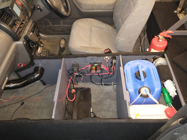

The middle compartment contains the auxiliary 100Ah lithium battery and electrics. The battery is way overkill but it was such a good price I couldn't help myself. Some tools will go in here as well.
The rear compartment contains a 20L water tank, 10L diesel tank for the heater and most importantly some decent speakers. I'm not really keen on having diesel in the cabin but I cannot think of anywhere else for it to go.

How long will the 10ltrs of diesel last running your heater?

I got a diesel heater indstalled in my SJ trailer now and have only ran it testing for 3-4 hours. Cannot see the the diesel level gone down so must be less than half a litre.
Does not have to be on more than lowest setting on a small room like this.

I got the same fridge as you or one size smaller. Annoying that there is no hooks on it for straps. Will boldly screw on some hooks one day when I get more fed up or collect the courage for it.
