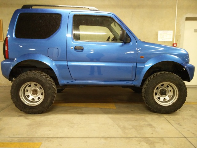

Nice work, definitely looks better with the bigger tyres. I have just fitted a 40mm lift and it feel so much taller, you must feel like you are up.wirh the gods on a 4" lift. Keep up the good work.
- Posts: 9996
- Thank you received: 1999
14 Jun 2020 09:16 #223573
Replied by Lambert on topic How about both Comfort & Capability in just one Jimny
I have to say it certainly looks cool up there. Only thing is from what I have read on here and elsewhere I am not sure that a 4 inch procomp lift is going to satisfy your requirements of comfort and capability as that have a fairly well deserved reputation for being very stiff and bouncy.

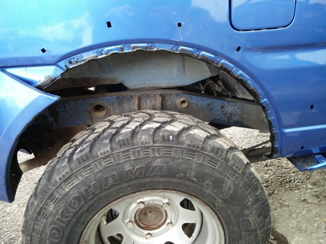

The 30'' tires were rubbing everywhere and I could barely get out of the garage.
It mainly rubbed here:

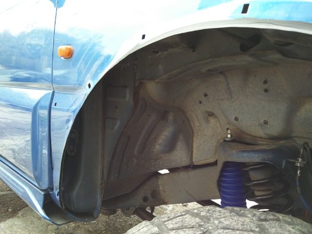

I undertook some quick trimming procedures
and these large gaps opened up at the front, which would be difficult to clean...
Do you have any solution for this?

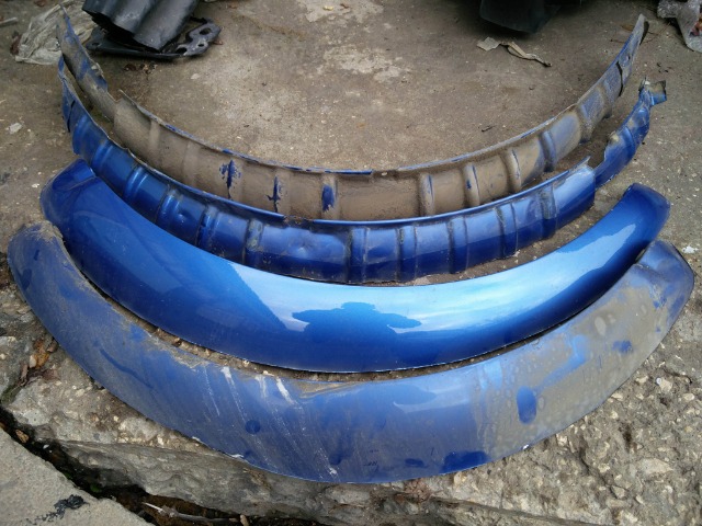

In the end, the Jimny parted with this much metal:

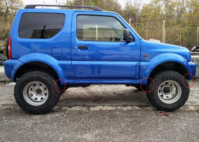

The final result - much better

Replied by jackonlyjack on topic How about both Comfort & Capability in just one Jimny
You've done a nice job their
If you would have fitted +4 arms only the front bumper would have needed a trim
I have +3 arms on 2" lift and my wheel base is 1" longer than standard
