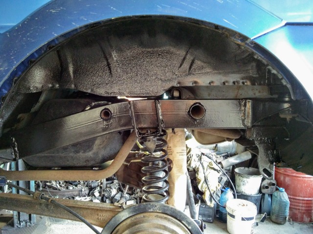

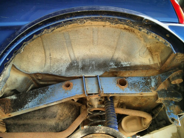

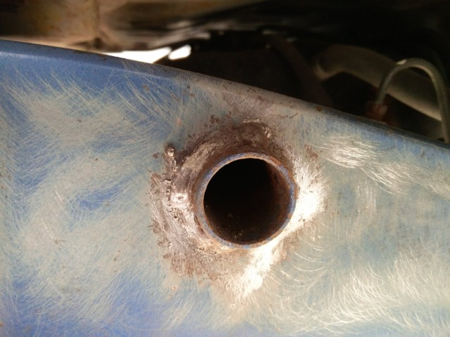

The Jimny is in pretty good condition but it still needs good care if it is to last longer.
Scrub off the rust as good as possible
Followed by Wurth's rust converter
And after waiting for a couple of hours - Hammerite's black paint 3 in 1
Before and after:
This might not be the Best way to treat a bit of rust, but from what I have heard, this should do the trick.
Have you done a similar procedure? What was your approach? How long did the effect last (how does it look after an year or two)?
Before and after:

I use Hammerite under mine too and paint it yearly or every other year.
I think I shall look to get some Lanolin too at some point.

"Yearly"... To be honest, I was hoping that I won't have to repeat this procedure for a few years
Will I have to scrub off the old paint before putting another layer of paint on top next year?
