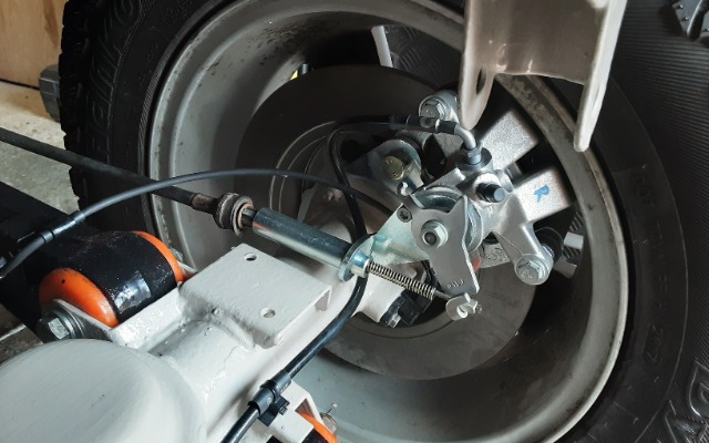

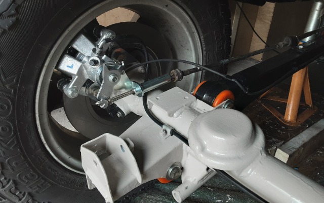

Hi everyone. I hope you're all well.
I'd like to think this is my last issue regarding disk brake conversion. Seemingly I have short handbrake cables for this setup!?!
I would need an extra 2-3cm/1 inch more lenght in order to be able to hook up the end of the cables or to put back the adjusting nut.
Perhaps I've missed something obvious again
but as far as I'm aware there isn't too much option to adjust the lenght of the cable, is it?
Any constructive advice is greatly appreciated.

I've got no clue what permission I would need to access the page but here are the photos again. This time maybe works...

Got them out! I can confirm that I followed the instruction as per my best understanding (which is hopefully up to this task!
) Perhaps I need to fit the actuators in a different position to allow cable ends being closer to lever? Just an idea, I'm not sure.

Replied by Riccy on topic Rear diskbrake conversion
The handbrake cables should be further into the new metal tubes. In the pics theres 1-2cm further to go in there (the rubber butts up to the metal tube). They will be tight and its worth putting some grease in the tube as you assemble it (to make it possible to get off in the future).
