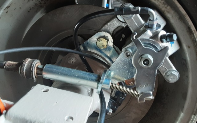

Was just about to type exactly what @Riccy has said. Can push them into those tubes another 20mm.
I left handbrake cables hooked up and connected at the lever end. Connected the cable at the caliper end last, by levering the caliper actuator as if the caliper was braking, and then hooking the cable end in.

I cannot pull the protecting cover of the cables as their movement restricted on the cross member mount.
But I was able to reposition the actuators on the calipers and that seemingly did the trick! I'm unsure if the actuator needs to sit on the torx head nut or not though.

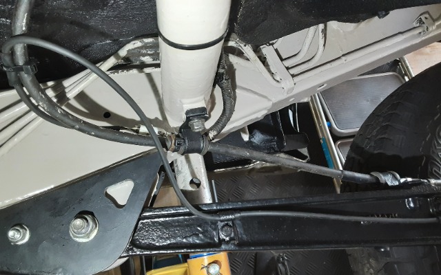

If nothing else works you could think about shortening the metal tubes of the hand break close to the caliper. This way the complete length of the „outer sleeve“ of the hand break cables would get shorter. I would expect that the outer sleeve is still sufficiently long for a proper routing to the hand break lever, even with the axle at its lowest position.

Replied by mlines on topic Re:Rear diskbrake conversion
This is the part we are talking about. The end of the cable should be pushed in flush with the end. In the picture yours is not.

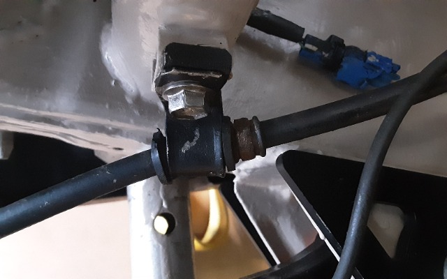

I do understand that you say I need to push the black rubber hose fully into the shiny metal sleeve but it's not possible without removing the mounting bracket from the cross member of the chassiss. There is seemingly a nut (?) on the rubber hose just before the bracket which stops it moving towards the caliper. The available lenght of the rubber hose is simply shorter than the distance between the mounting point and end of shiny metal sleeve!
The cable lenght issue has been resolved by rotating the actuator towards the end of the cable. However having the actuator in this new position it does not rest on the torx head anymore! (and yes the end of the black rubber hose is still not reach to the shiny metal sleeve)
