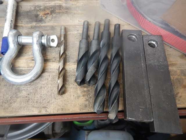

So... in a few spare hours recently I've been trying (being the operative word!) to drill some 20mm holes in some bar -

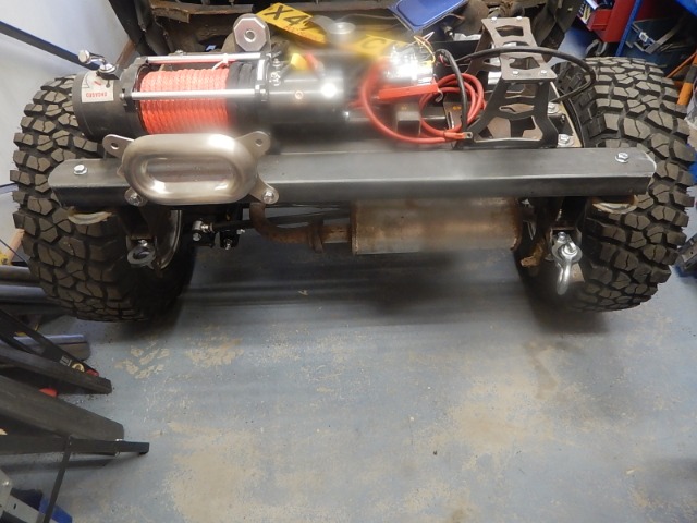

To make some recovery ponts for the rear...
No way they are going through though, even with pilot holes, bigger drill, etc, etc...
So I remembered GV42 had a set advertised on this fine forum, but thought they would stick out to far with no rear bumper, BUT that got me thinking about JimnyBits' tw0-plate construction, and an idea formed in my head (yes, and then died a lonely death! :lol: )

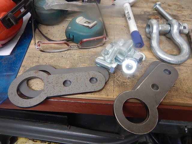

I had these CNC cut to make some anti-roll-bar disconnects up, but have yet to sell any in kit form, and haven't got the time to weld them up into complete bolt-on solutions... so I "stole" a few from stock...
I drilled the chassis to suit and bolted them in place...

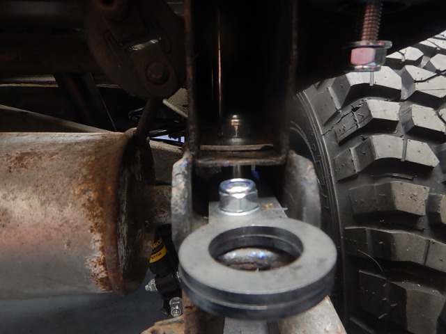

You cam just abut see the second hole / bolt goes through both the tow boint bracket and the chassis rai and has a small sleeve on top to stop them been pulled together and clamp it in tight...

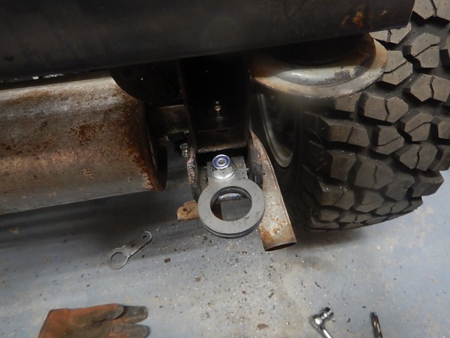

And then did the other side
Matching pair!
Matching pair!
