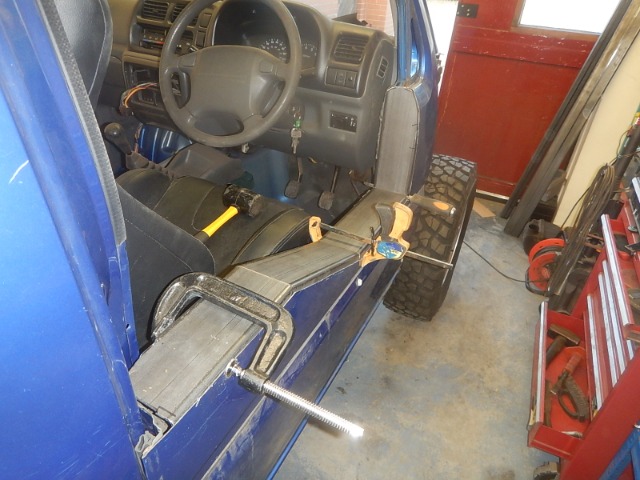

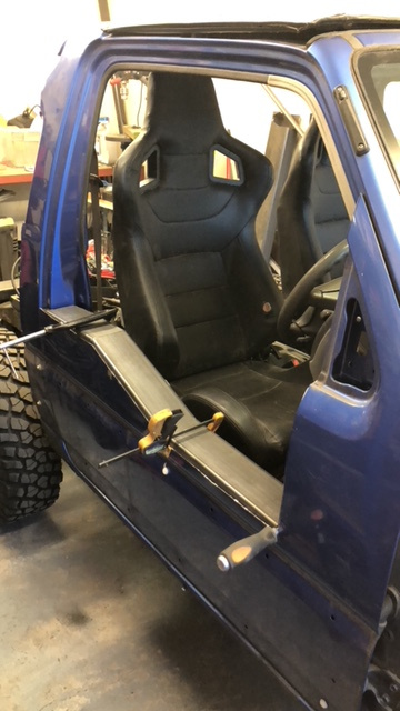

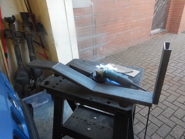

Back onto the half doors then!

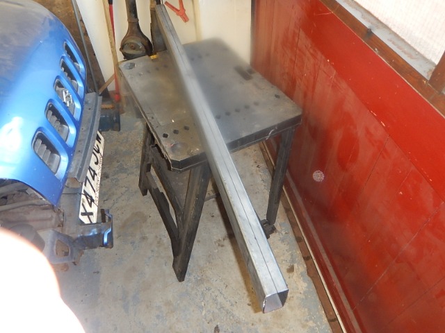

Take one length of 4"x2" box section... and add an angle grinder with a slitting disk in it...
Cut in half to make two door top inserts... well, actually one, I've got another length to make the other door, as I noticed one side has the seam in it and wouldn't look good in the door opening, so those two pieces will be used to seal up the cut in the back of the cab..
See the left one?

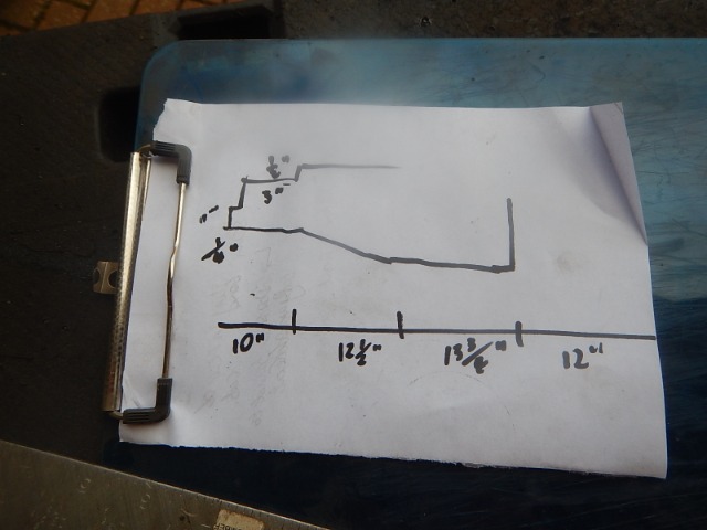

Measure...
Cut. fold...
Trim, insert, re-trim, etc, etc...
One done!

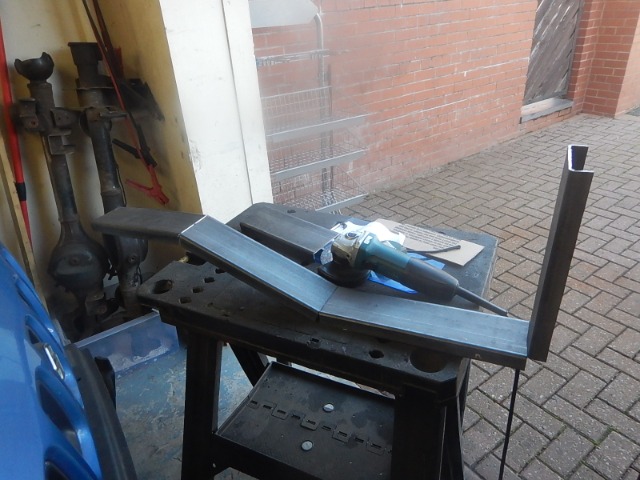

See the left one?
Measure...
Cut. fold...
One done!

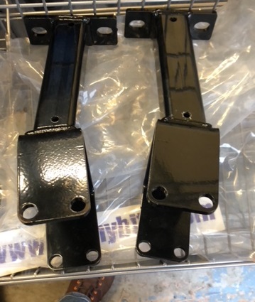

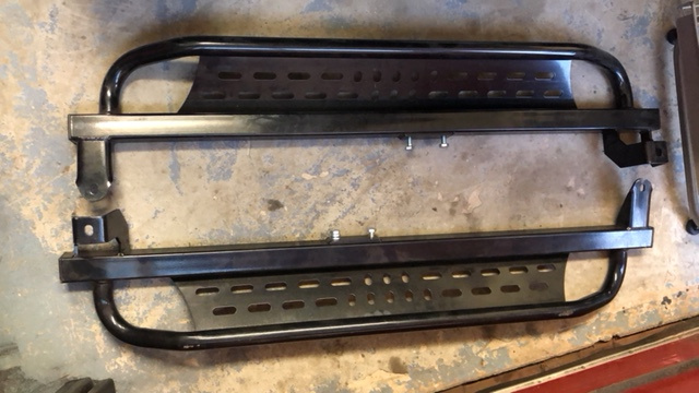

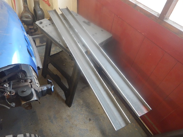

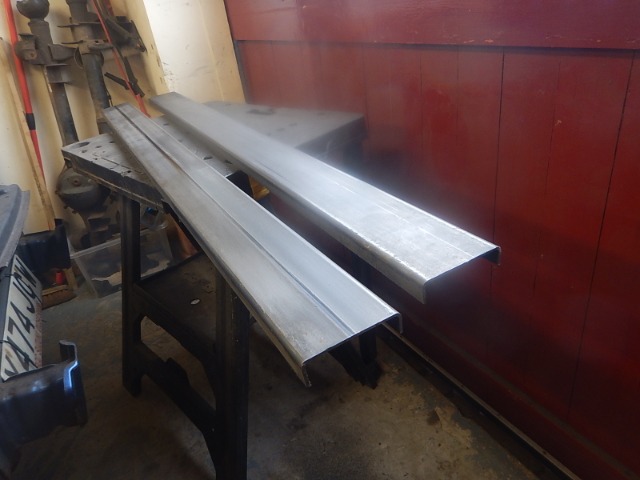

A bit of a bargain and a mutually convenient transaction (arrived) yesterday...
Staring at the buggy a week or so ago I figured it needed some sill protection, so I started looking around at the price of them, and considered bending up and making my own... but I figured a quick email to Rus over at JimnyBits wouldn't harm first... so I asked if he had any lying around / seconds, etc... He replied saying he did indeed! An end of a previous run before a small design change had left them with two driver's side bars left in stock... Something that's happened to me a few times in the past! :lol: I've got two different shaped front bump stop extensions on my desk for instance, from different production runs from Rockwatt, don't know if I've shipped two unmatching ones previously or just had odd numbers in each batch, but it does happen... Anyway...
Rus said they'd need the mounting brackets cutting off and re-welding on the other ends, and the threaded bolt holes that attach to the mid-bar to the chassis brackets would also need moving, and then obviously repainting... not a problem for Mt. Angry the angle grinder!
See? The mounting brackets on one of them are the "wrong way round" as they are both driver's sides...
The mid-bar to chassis brackets are handed the right way though
Rus said to me to "make an offer", so I did, a mutually acceptable amount so that I got a bit of a bargain - but some work to do to the bars - and they sold them on without having to rework and then powdercoat them again (which never ends well in my experience), or scrap them / wait for two customers that need to replace one driver's side bar, not likely?...
So a win / win transaction! Many thanks to Rus and JimnyBits!
And that will also finish the alomost-full compliment of JimnyBits protection guards under the buggy - front and rear shock absorber guards, radius arm to chassis mounting guards, fuel tank guard, and now sill protection bars
The only other guard under there is the transfer box bucket I made myself earlier in this build thread as I'm not aware of one on the market for a standard Jimny transfer box?...
I'll cut and weld them soon when I have some more time...

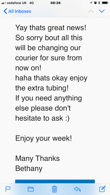

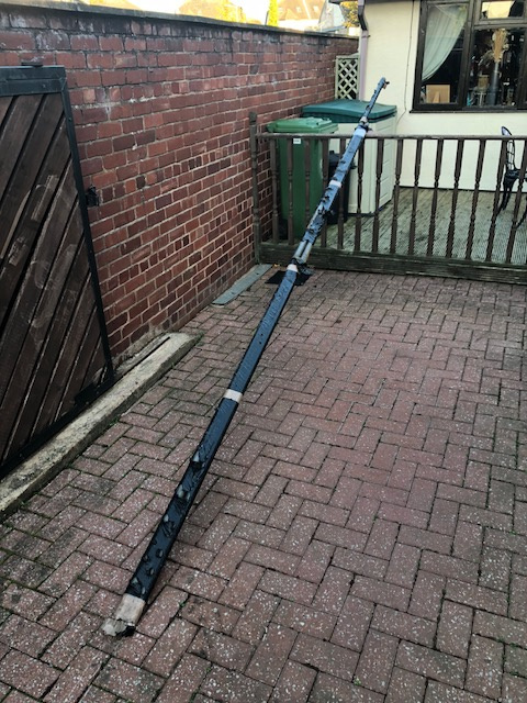

Yesterday - FINALLY! - the seamless tube for the winch rope guide turned up -
Ummm,,, there sees a ot there?
I measured and checked the order and then emailed them to say the order had finally arrived - as the courier 'lost' the first shipment of four metres long?! - BUT I'd got too much? The larger diameter tube to make the insert sleeves where the smaller diameter tube meets the donut fairleads had been shipped as 5000mm (5 metres) when it sgould have been 500mm (half a metre!). I cheekily asked if this was compensation for the ten day wait for a next day service...
Result! :lol: Honesty is always the best policy (my Mum taught me!) and they told me to enjoy the free extra 4.5 metres of tube! That's enough to make the 'X' in the back of the cab
