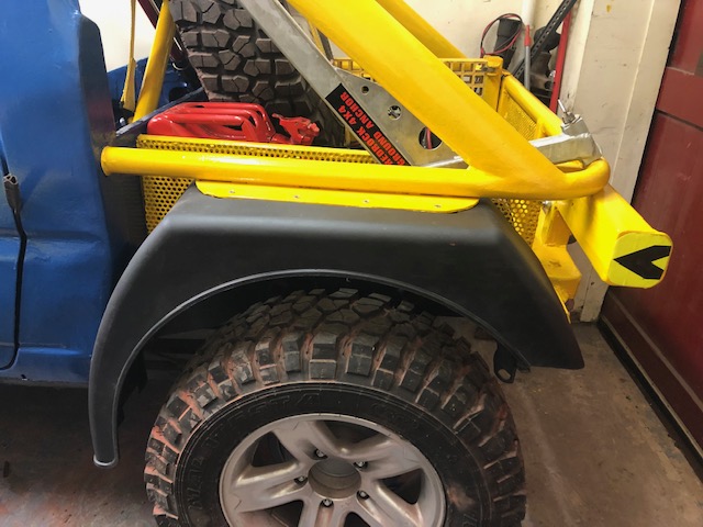

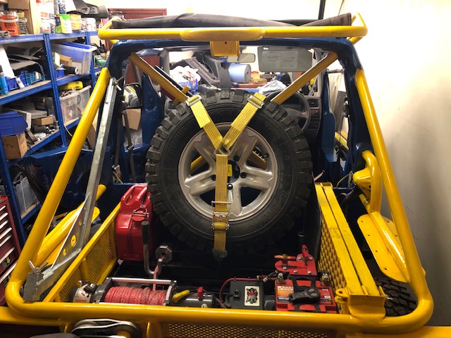

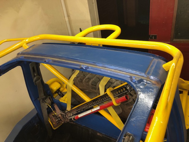

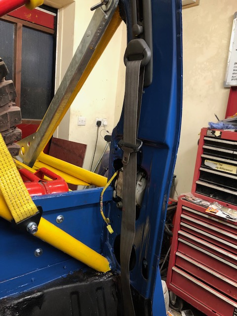

Reassembled the back a bit... spare wheel strap in, the faux Jerry Can that holds my tree strop bolted back in, the spare relocated and strapped down, which in turn clamps the ground anchor 'spade' in place. and the hi-lift jack mounted inside across the X in the cab...
And the seatbelts reattached too...

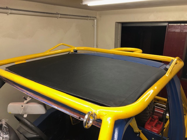

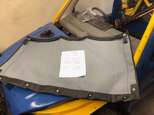

New soft-top front section arrived this morning, so it would be rude not too...

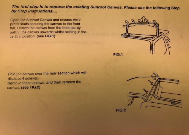

Sounds simple enough...
LOL :laugh: "Remove these screws" that have been in place for twenty years!!! :ohmy:
Beat them into submission with a suitably sized screwdriver and a big hammer... "tapping them lightly' ( :lol: ) can shake them loose a bit!
And of course one of the four refused to come out and rounded off the crosshead hole in the top... so I angle grinded a slot across it and attacked with an even bigger screwdriver! :evil:
All out in the end though and the old hood removed...

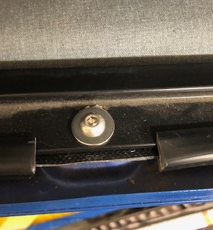

On reassembly I replaced the old "screws" (M6 bolts actually) with some nice new stainless steel ones with hex heads...
A fair bit of fiddling about later...
And finally the new hood is in place...! :woohoo:
So I've left it down to stretch into place in my nice warm garage...
More soon!

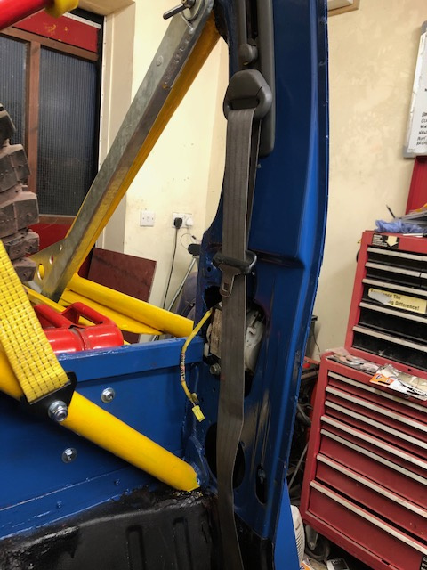

11 Dec 2020 18:54 #230850
How have you managed to get the belt to retract? Mine don't do that without assistance.

11 Dec 2020 23:46 #230859
Twenty years on... but both working fine! :woohoo:
Mr. Sheen sort of thing then Maverick?
- Posts: 9995
- Thank you received: 1999
12 Dec 2020 04:37 #230861
Will give the polish idea a go because the current situation is very agitating.

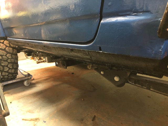

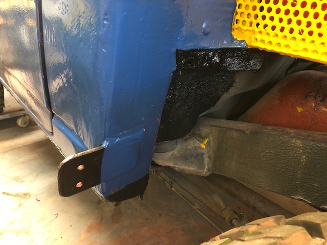

I started by marking a tape line along the sill and then undersealed the bottom of the sills inside and out with Hammerite Underseal -
With added Waxoyl
Messy job but well worth it...

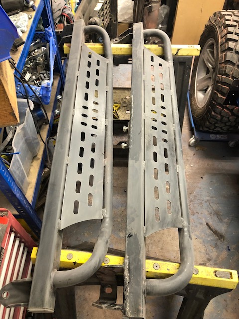

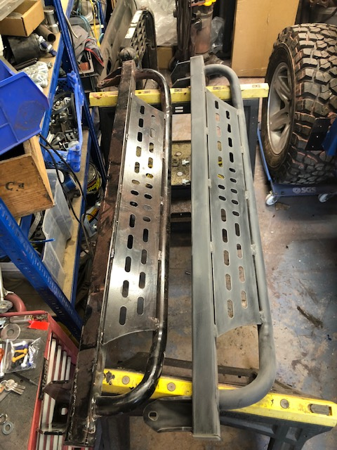

I then attacked the JimnyBits side bars with a sanding sponge... one done!
And then the other... you may remember I got these reasonable as they somehow ended up with two of the same side at the end of a production run, so I cut and shut one to make it right for the other side... They've been on the buggy during the build so have been scuffed and dripped on with filler and paints, so I decided to sand them down and repaint them... I wonder what colour?! :silly:

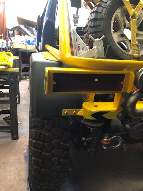

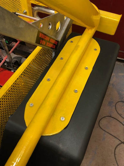

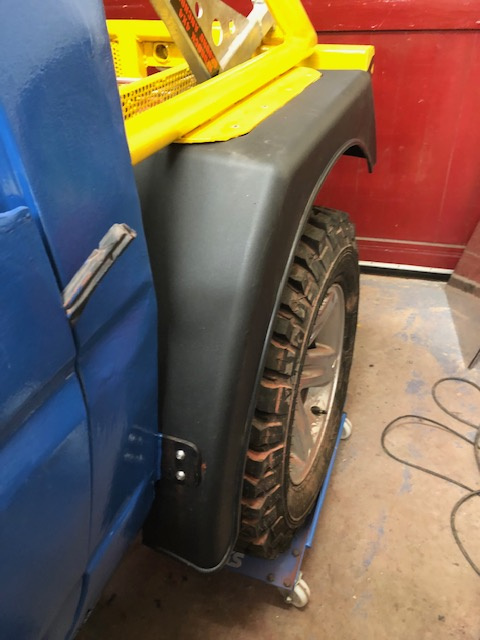

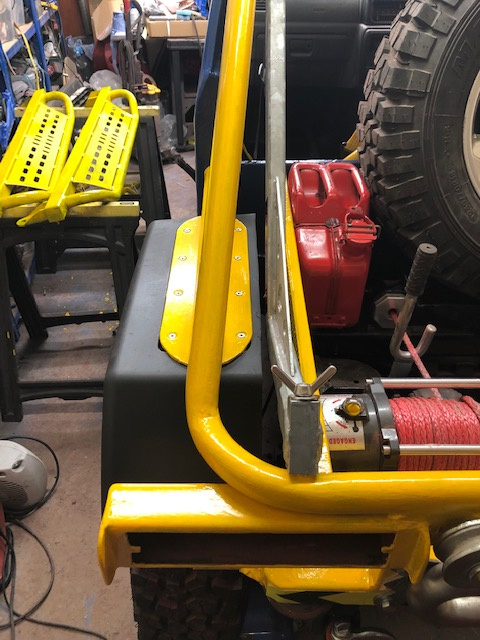

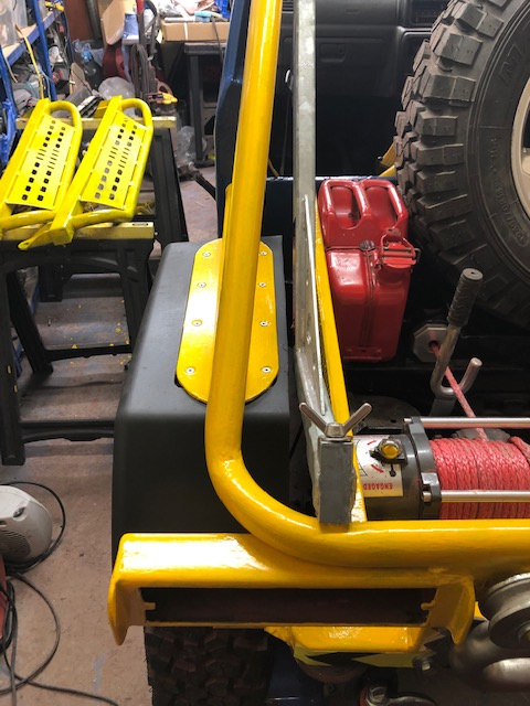

While they were put to one side to dry I started reassembling the rear mudguards
All stainless fixings everywhere
Aha, there you go... if you hadn't guessed the colour of the sidebars, there they are in the background of this photo
Yella to match all the other added bits of tube! :woohoo:
Done!
