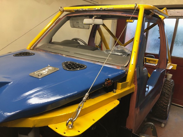

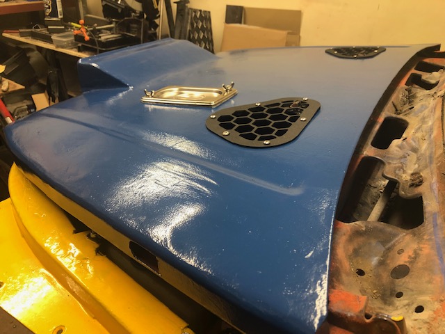

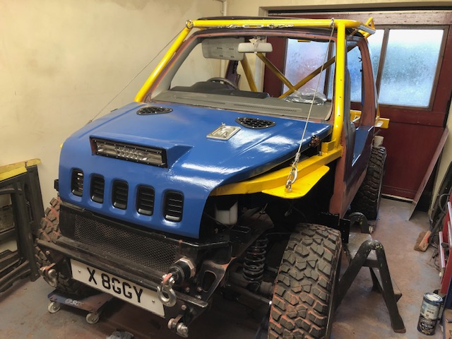

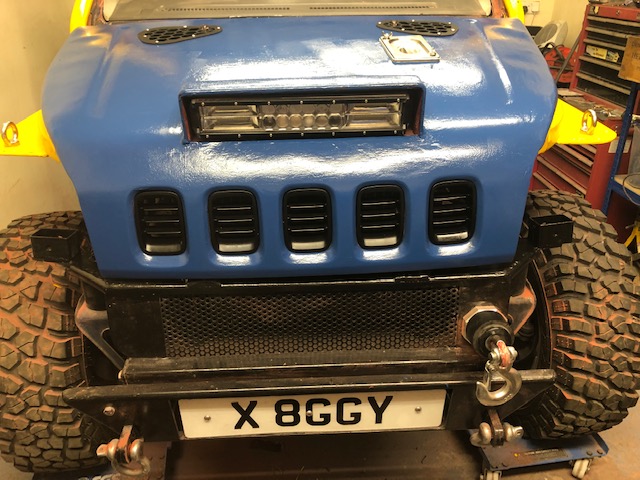

For once, I had a fiddle after work tonight...
(Re-)Fitted the Pie-Pot*, the (Keithy-built) bonnet vents and the five inserts in the front, now that I'm as happy as I can be with the finish of the bonnet...Considering it's been cut and reshaped and a oval tube section welded into both sides to form a new edge, by a complete amateur... it doesn't look too bad!
*If you haven't seen the "Pie-Pot" in this build thread before, it's a bain-marie pot of the right size to hang down from the bonnet lid above the exhaust header, and has enough room to fit a couple of pies or pasties in, it's taken inspiration from the American Buritto-Box but is accessible from the outside of the vehicle without having to lift the bonnet... The idea is at the start of the days greenlaning you pop a couple of pies / pasties in (wrapped in foil) and then after a few hours driving and enjoying the views of the countryside you "stop for lunch" and retrieve a nice warm pie!
Looking the other way... you can see the hole for the side repeater in the edge of the bonnet, and the wing-nuts holding the Pie-Pot lid on :laugh:

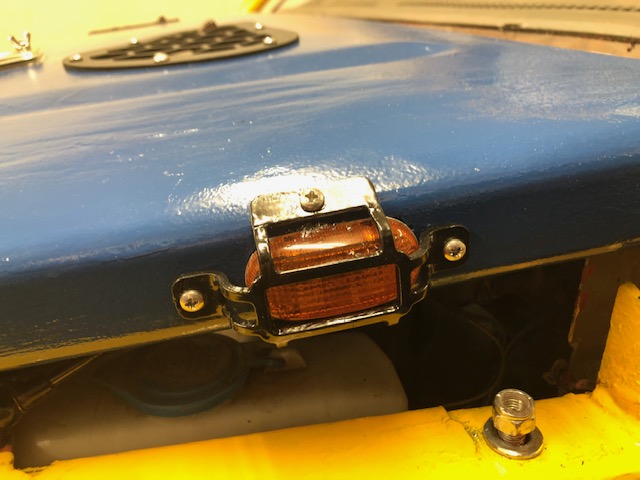

Waiting for our delivery, so I sloped off for a bit... as you do!
And drilled and self-tap screwed the slightly modified (bent to suit the curvature of the bonnet edge) JimnyBits side repeater guards...
The repeaters will also be protected by the wings when they are back on, and the tree wires when they are in place...
So that's the front coming together too!
