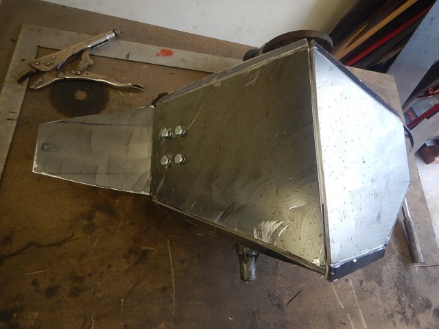

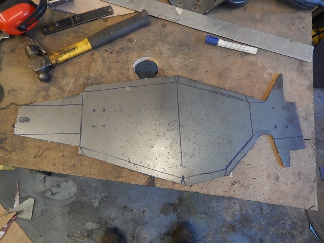

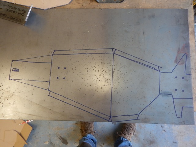

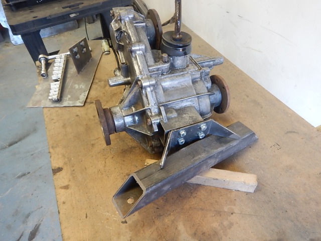

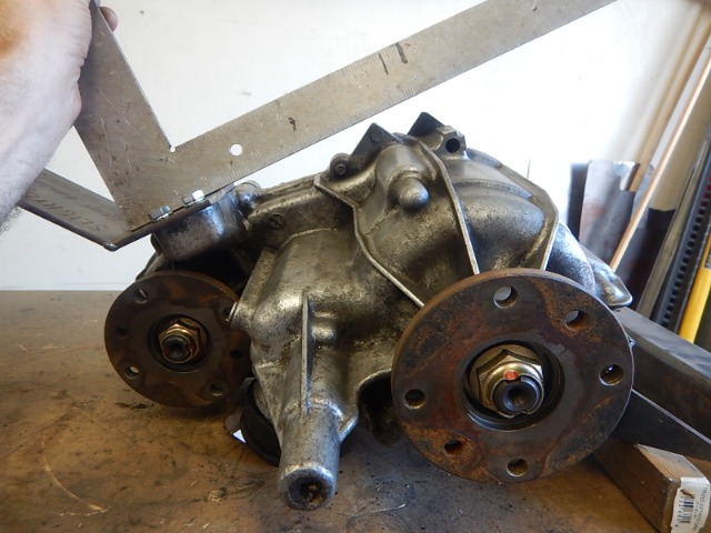

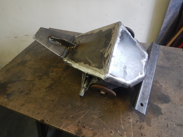

04 Sep 2019 16:59 #213138

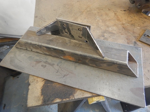

This is the jig I mentioned above -
You can justa bout see the dowels pointing through the 4 mounting holes, nd the box section mount has two holes corresponding with two holes in the steel plate base, a couple of bolts through them and line the pegs up and we're good to weld... usually... but I want these to be a bit longer...

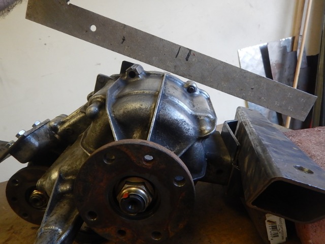

So mockup the mounts and then...

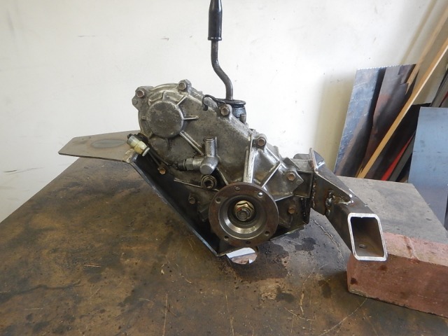

Turn the box over with the lever through the peep hole in the 'bench; and start looking at the angles...

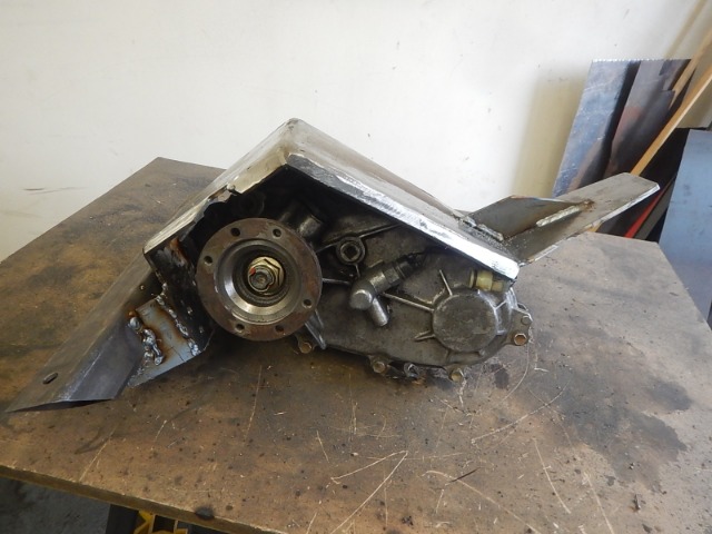

And then the other side...
Experiment with some cardboard!
We shopkeepers have plenty of cardboard boxes lying around
Happy with the design so transfer it to 5mm steel plate!
Voila!
And then cut it out with a bigger pair of scissors, or even an angle grinder
Cut two thirds through the plate to make the bends...
And the beaver away forgetting to take more photos! F'Oh! :lol:
Almost done but run out of time....
Will finish it off on Sunday

04 Sep 2019 17:33 #213141
What the hell are you expecting to hit? You could jack the car off the ground on that! Good work, love it.
