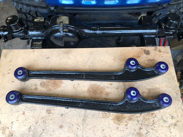

Bit more towards the buggy today...
Painted the radius arms and the axle casing twice, then fitted the SuperPro poly bushes into the radius arms, and then fitted them to the axle casing -
Replacement diff (4,3:1 instead of 3.9:1) also painted (on the floor)
Ready for reassembly / rebuild soon...
Slight oddity... the bush kit I bought (off myself as it was left in B4V stock) was a castor corrected kit, but the buggy is only having a minimal (1.5"~2") lift so won't need it, so I chose to use them to reposition the axle slightly forward to help clear the firewall...

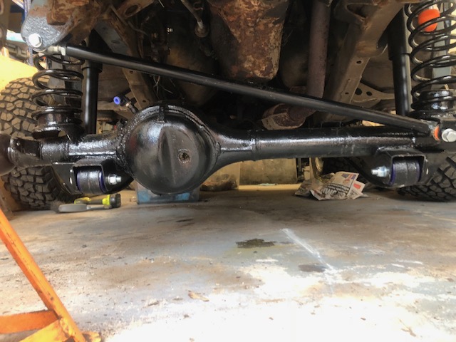

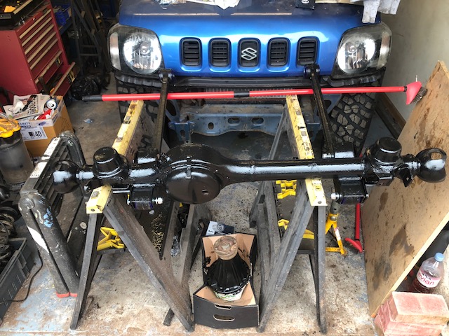

Back to the buggy today... after first fixing the Gold daily driver (replacement panhard rod bolt for the MOT retest) and S200KYS (new JimnyBits front panhard rod fitted to go with the re-affixed panhard bracket! :ohmy:
Front axle casing ready to go back under... freshly painted (a few weeks ago!), JimnyBits front shock guards, SuperPro poly bushes, breather elbow tapped and fitted, shocks are Monrow Adventure Grand Vitara rears which are +1.5" over Jimny ones...
Radius arms reattached, with JimnyBits guards...
Front suspension fitted... fresh new standard front springs with spring spacers on top, bump stop spacers and poly bump cones, Monroe shocks as previously mentioned... and SuperPro castor correction bushes set to push the axle forward rather than re-align it..
All in place with a JimnyBits front adjustable panhard rod...
Next step will be the transmission, so a later VVT diff is painted and ready to go in to adjust the gearing for the bigger tyres - 4.3 rather than 3.9's, new bearings and seals everywhere, and get the wheels and tyres back on... push it out to get the feel of it, where to cut the front body panels off
etc, and tidy the garage and push it back in again...
Transfer box then needs to come out and get armoured, new brackets and a bucket...
And then spend the winter fettling it into a buggy shape
