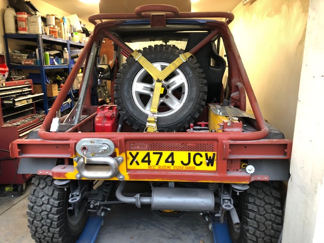

Alan's pointed out (by email, he reads here but doesn't post) that my MOT man won't like the spacing of my number plates...
When it goes for MOT it will still have the original registration, and hence these plates...
IKEA meets the Subaru Racing Team... :woohoo: :lol:

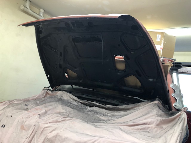

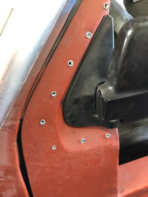

My new / replacement Riv-Nut gun had arrived in the week, so I started with that... and then pushed the buggy across the garage (it's on dollies) and then marked, drilled and Riv-Nut'ed the driver's side guard too...

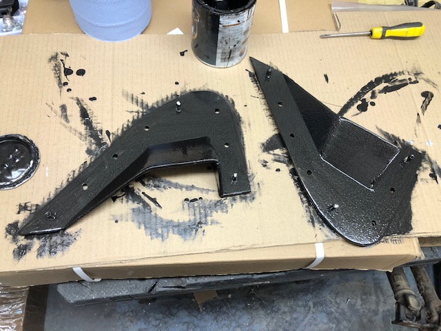

And then whilst also doing the other jobs to follow, I gave the mirror guards two coats of black Hammerite paint through-out the day...
And also painted around (half of the edge) where the Keithy-made bonnet vents are going to sit and inside the cut holes in the bonnet...
And then went and asked the missus if she had an old sheet I could have to mask off the engine bay while I bed-liner'd the inside of the bonnet...

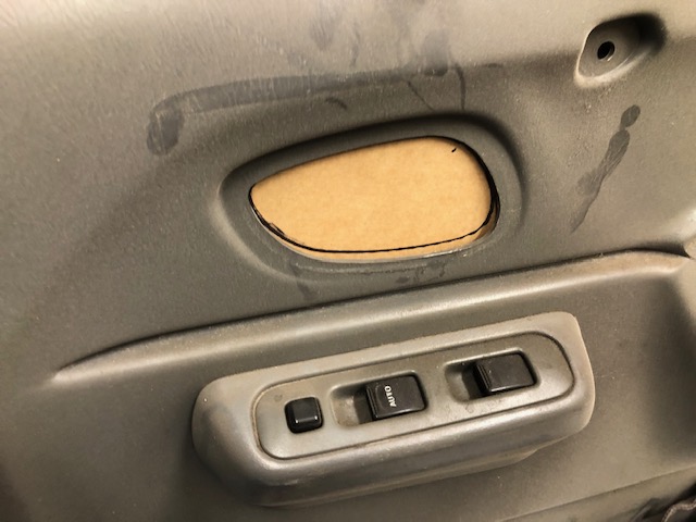

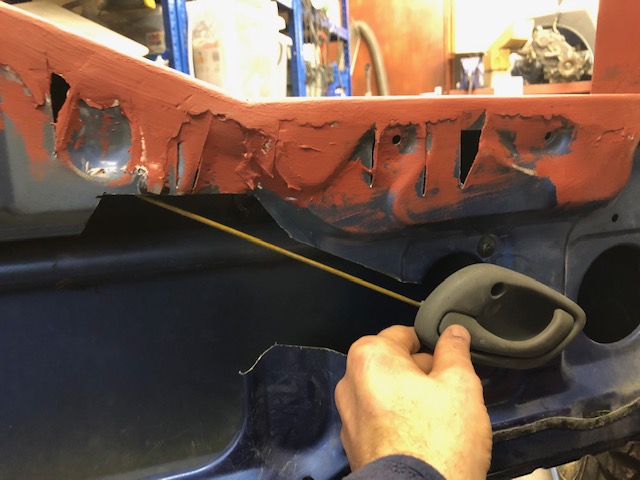

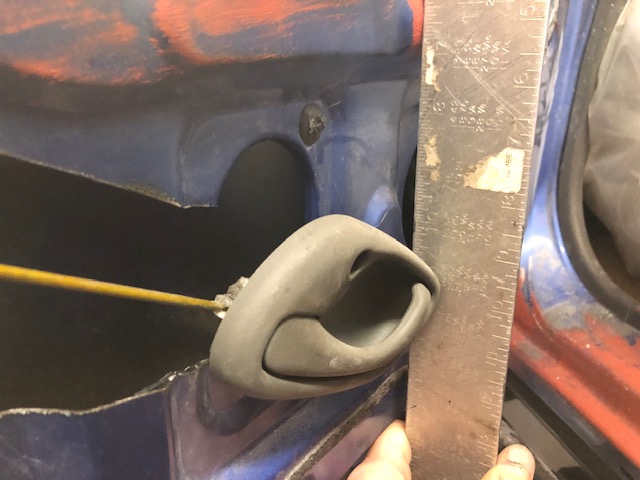

I then I turned my attention back to the door cards... you may remember I'd already made the cardboard templates? Today's job was to work out how to relocate the door handles...
They'll sit in holes cut in the aluminium chequer plate door cards, but lower than Suzuki envisaged

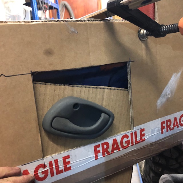

Back to the original door cards to draw a template within the handle cut-out...
And then transfer that to a small square of cardboard...
Cut an oversize square hole in the doorcard carboard template and then align the two templates and draw within the square...

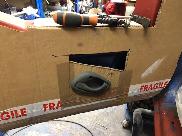

Then cut the door handle template piece to shape and parcel-tape it in place... and then refit it all to test, making sure the handle can be poked through the chequer-plate version when it is made, with the bent bit to resemble a step in the half door... fidly.. but it'll all work...
I'll have to do the same with the driver's side later, to make sure the door-opening metal rod is tight where the handle is positioned...
I'll also have to mount a bar within each door for the handle to be self-tapper'ed to...
