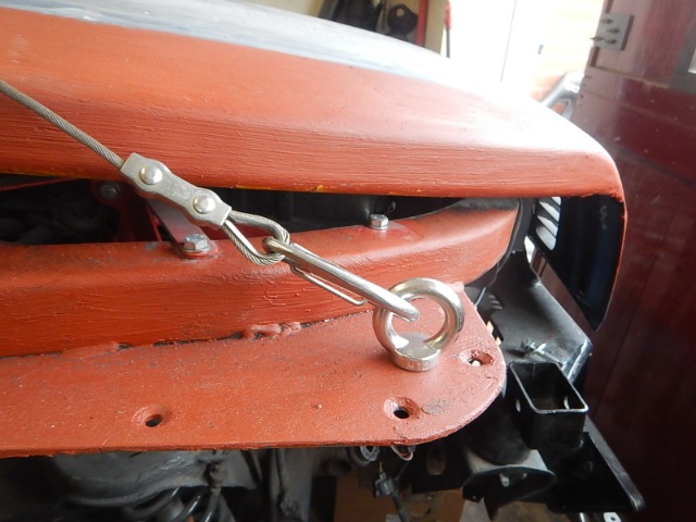

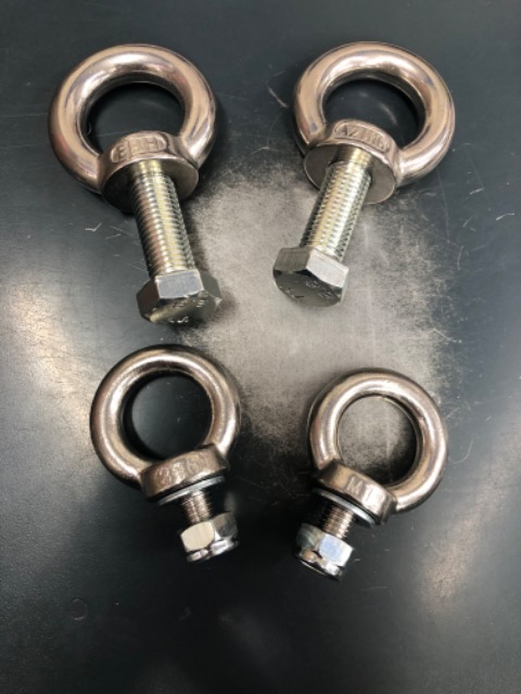

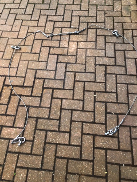

So the big lifting eyes go on the ‘halo hoop’ above the windscreen, next to the A-pillar bars which is what prompted me to get them now, might as well weld the mounts (those big M16 bolts) on at the same time?... Then the smaller clips on the end of the (Rescue helicopter winch) stainless steel rope just fit through the loops and clip to each side of the turnbuckle which ends up above the middle of the windscreen... The other ends of the cables will clip to the top of the front mudguard mounting plates using the ‘smaller’ M12 eye bolts..
There’s always been some question of legality of driving on the road with “tree wires” fitted, so I made these many years ago so that they can clip on and off quickly and easily, and just attach them for the mad lanes
So to fit them you just have to clip the four ends of the cables to the wing tops and turnbuckle and then stand on a tyre and tighten the cables taught with the turnbuckle... Simples!

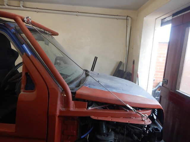

I started with the tree wires as they were fresh in my mind as the lifting rings had arrived yesterday...

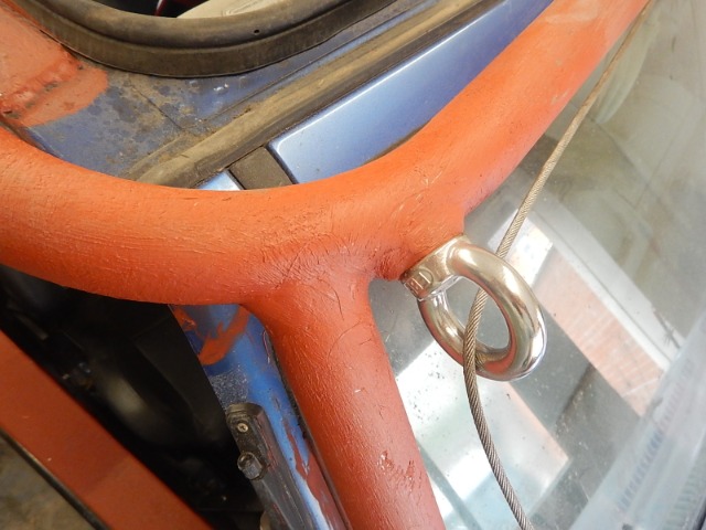

So the cable runs from the top of the front wing mount and up through one of the huge rings on the 'halo hoop' of the 'cage'...
I mounted the ring just next to the A-pillar bar... it's M16 so I cut off the head of the M16 bolt and drilled a hole in the halo hoop and poked the threaded bit of the bolt into the hoop and then popped a washed over the top, then worked out where the thread needed to stop so that the the lifting ring ended up in the right place, and then welded up to the washer to make the shaped mount for the ring...

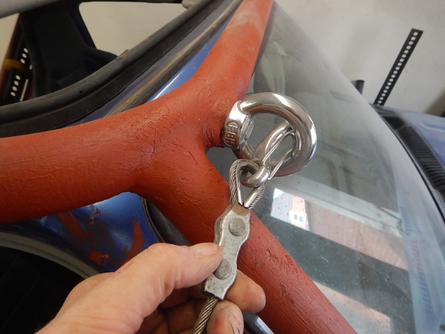

The idea being that the smaller hook at the top end of the cable (that connects to the turnbuckle in the middle of the halo hoop above the windscreen) JUST fits through this huge ring, so you first clip the cable to the top of the wing, thus -
And then thread the other end through the big loop, and attach it to the turnbuckle, and then when the two are in place, tighten them taught with the turnbuckle...

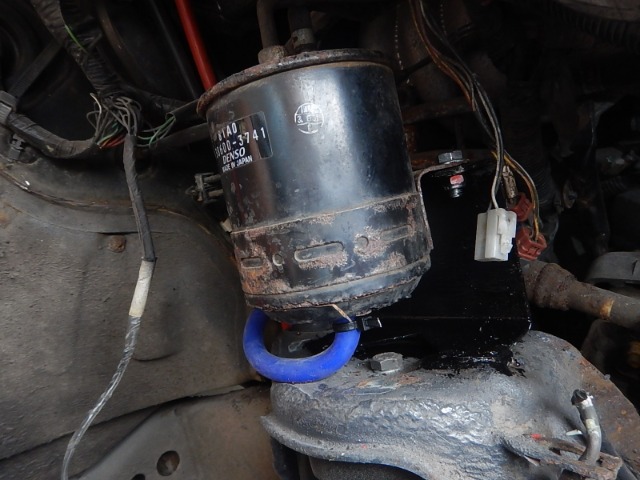

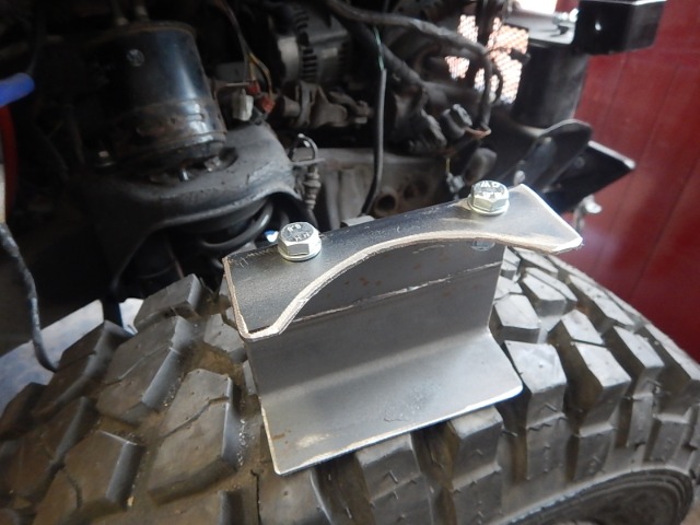

I then made a mounting bracket for the charcoal canister thingamebob...

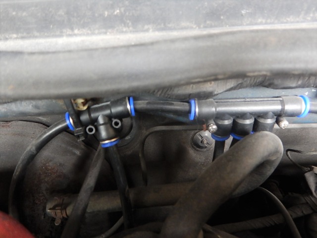

And with it welded to the top of the spring mount, I painted it and then bolted the canister in place, and then added a BREATHER silicon hose, that leads up to...
An additional T-piece in the breather system...

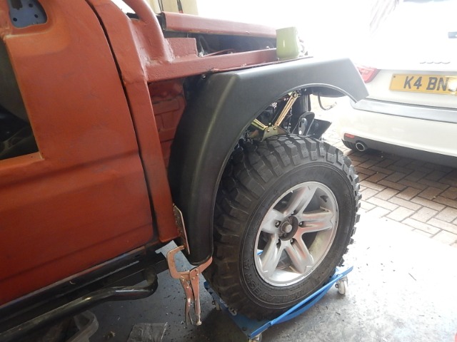

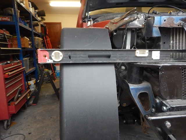

Then onto the front mudguard mountings...
Having..
... adjusted the rear mount to the shape of the mudguard...
And trimmed the front to suit... deciding to go...
Level with the bottom edge of the bonnet / top of the bonnet slam, and half way in relation to the headlight...

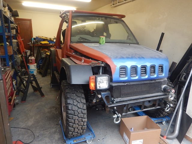

SO... that, I think, is the driver's side finished!
So, Wednesday, I'll push the buggy out of the garage, tidy the garage, turn the buggy round, and push it back in again...
Ready to start on the passenger side next Sunday...

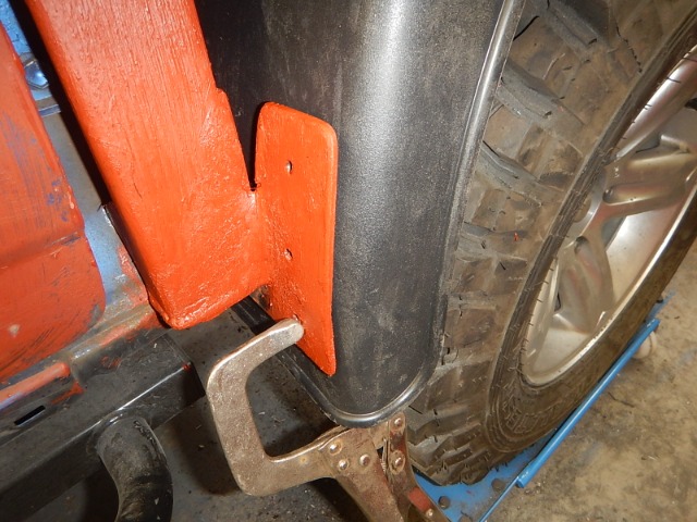

Having..
