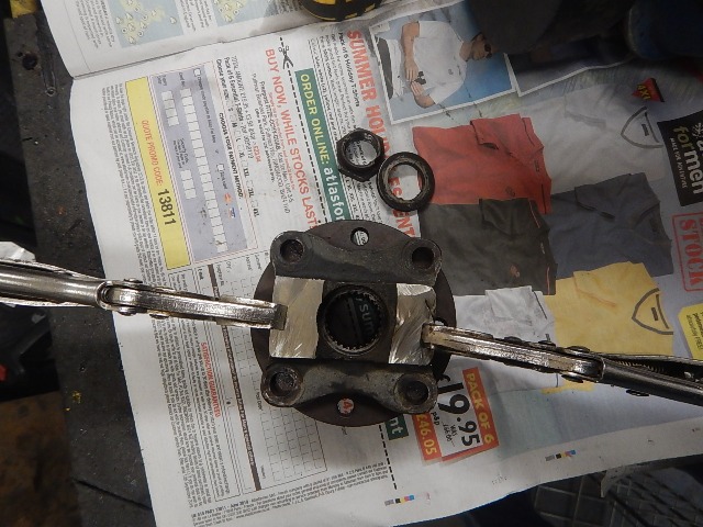

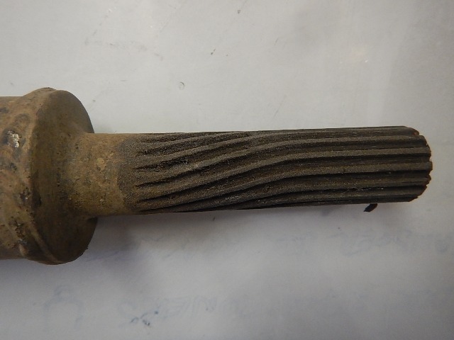

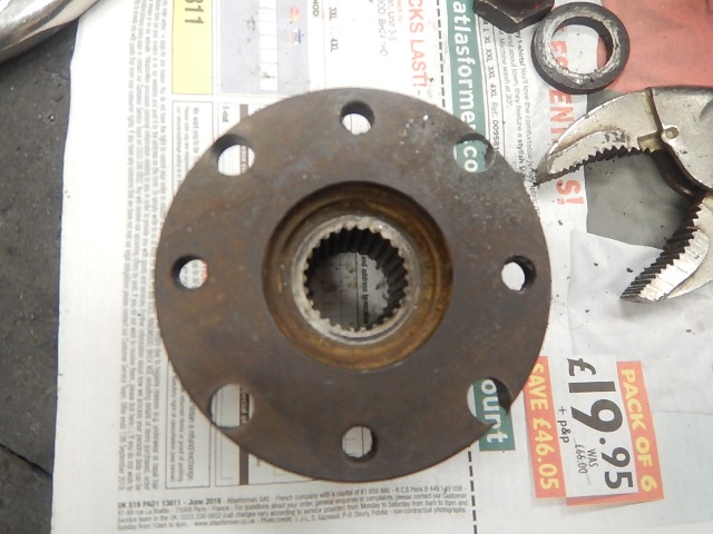

A break from the shop this afternoon, so I was having a tinker in the garage...
This is the template I use for re-drilling flanges... it's the end off an old prop...
This the other end of it (out of the slip joint) I kept this as I was strangely proud of it?! :woohoo:
Onto the pillar drill...
And we have a dual hole prop flange... 8mm and 10mm holes added
Better go and walk the Labradors!

The engineer in me is having a bit of a fit that those holes have broken through! The farmer in me on the other hand sees nothing wrong at all.
- X8GGY
11 Jun 2020 17:39 #223501
LOL :lol:
It’ll be fine... they can’t go anywhere
Besides, the bolts are location / clamping, the prop / flange faces are indexed and friction holds them together...
Hmmm, some BluTac and Gaffa tape too?!
