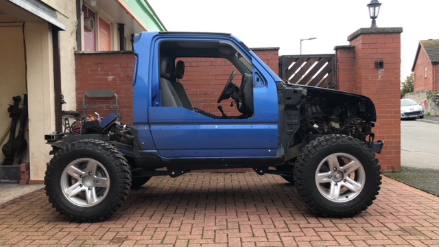

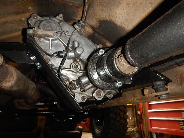

The transfer box is back in! :woohoo:
And all the props are back in place too...

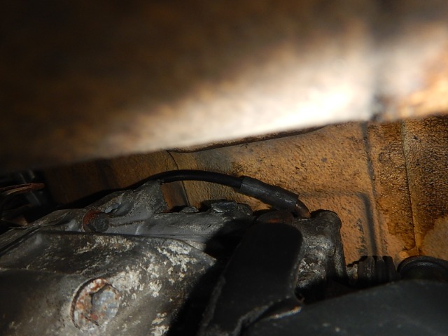

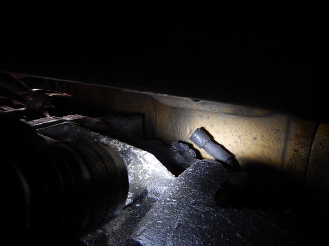

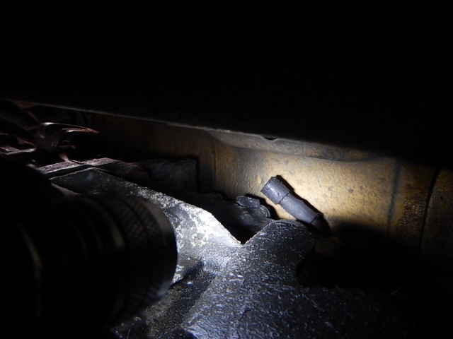

So the only one left to do was the gearbox... with this being a soft-top I already knew what I was looking for as S200KYS is / was also a soft-top... on the passenger / nearside of the gearbox you should be just about able to see the stock factory breather with this little cap on it...
It's quite snug but I could just about get both hands up to squeeze a (8mm OD) breather tube into the existing rubber hose on the breather...

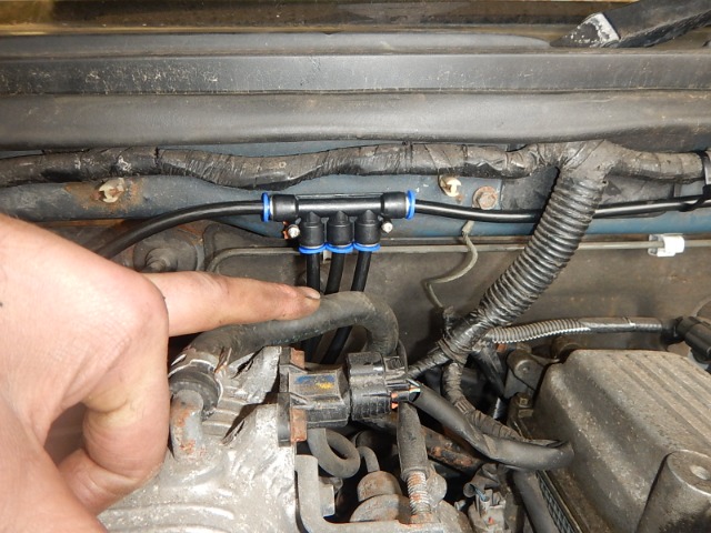

Tubes were then connected from all the elbows and separately run up to...
A five-way manifold block on the engine firewall
So the one on the left goes to the rear axle, the three pointing down go to the front axle, gearbox, and transfer box, and the one on the right will go to the highest position possible, in my case, usually up into the top of the snorkel's head

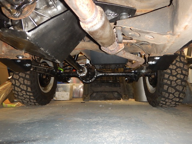

SO.... that's it! All the crawling around under the donor Jimny is complete!
the front and rear axles have both been rebuilt, the steering bars strengthened and renewed, and the sspension redone and lifted ~2", and the transfer box has been slung in a cradle for protection... oooh, and the diffs have been swapped for later 4.3:1 VVT model ones and a rear "Lockright" (Lunch Box) fitted along with Trail Gear rear shafts...

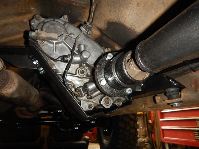

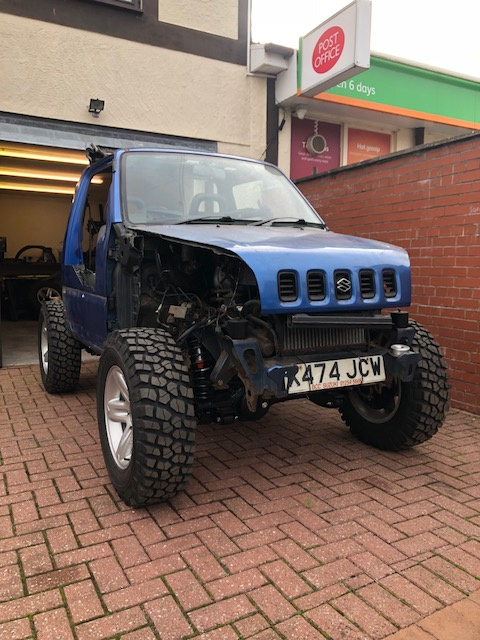

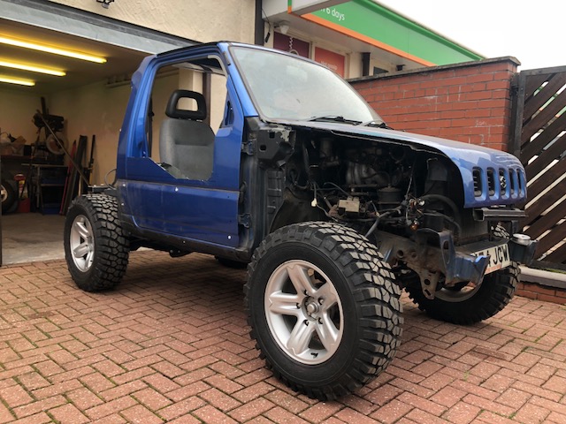

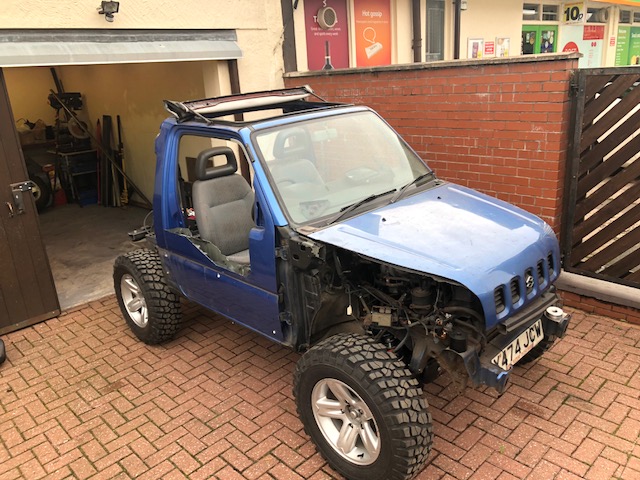

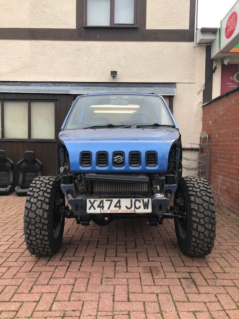

Front inner wings / clip have all been removed
Bonnet has been trimmed to shape
Doors have been cut down to 'buggy style'
Metal has been ordered to fill everything back in...
I decided in the end - with grateful input from Riccy
= to leave the doors functional, they will still open rather than being welded up - as Alan and I are both old scrotes these days, and throwing ourselves through a small gap isn't the best idea! LOL :lol: so the 'half doors' are to mimic the inspirational yellow buggy, still give enough wading depth, retain the excellent sized door mirrors. and also protect us from side impacts... and will make on-going registration and MOTs, etc, easier too...
More soon!
