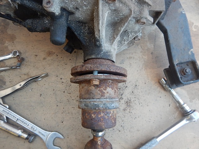

Fought to get the transfer box off... the rear prop's bolt refused to move so it came out still attached...!
A piece of angle iron across two flange bolts stopped the box turning while I fought to get the rear prop off on 'the bench'
I eventually won!

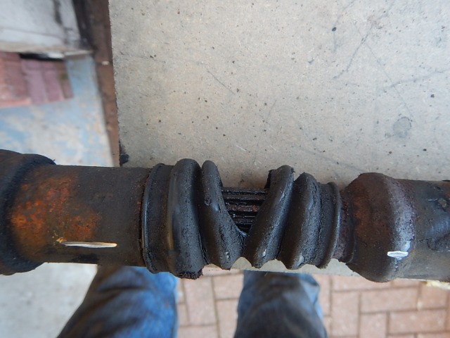

Front prop marked and then split to replace the torn boot and regrease...

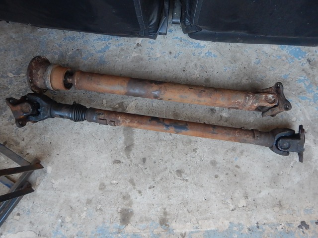

Both props cleaned a little and set to one side...

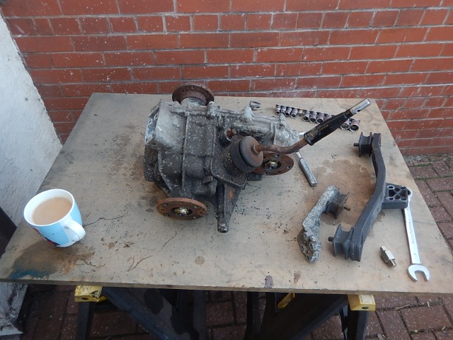

And I then stripped the brackets off the transfer box, and then...

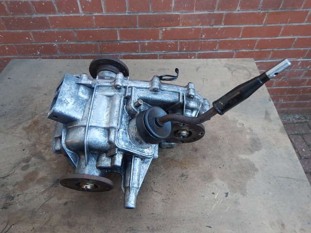

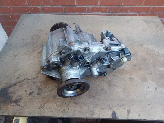

Gave it a damn good clean with degreaser... so it's all ready for the breather to be fitted and some new mounts to be fitted...
Just checking out Martin's instructions for the breather kit , on which my installation is based.

Box looking nice and clean
Just a little tip for tapping if you have a strong magnet sit it on top of the tap wrench
with a small amount of grease on the tap
will reduce swarf getting into the box
