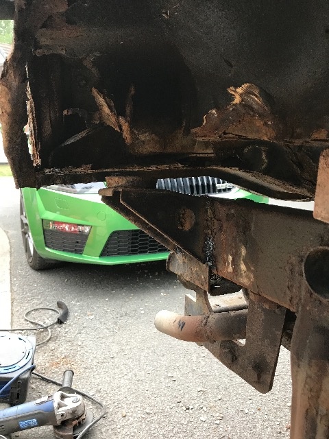

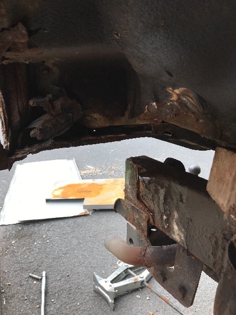

Patched up the chassis mount with one off a shotgun from the scrap yard just need to do the body part now but work out how to get the new body bolt through the chassis mount.... got a brake pipe from scrap yard off a Toyota Yaris or something to see if it gets me through a mot then I’ll sse about replacing it for a braided one.
Before the new mount
After the new mount quite pleased with it as my welding has some improvement to be made but has come on considerably from my first attempt

It's quite a liberating experience being able to do things like this yourself isn't it!
08 Aug 2018 05:38 #194911
Replied by yakuza on topic Sheet steel
Grind off all rust and keep it clean while welding. Also when you weld outside you can make sure there is no wind (or less) that can blow out the gas from your weld nozzle that is supposed to prevent oxygen from entering the welding flame. Just a tip
