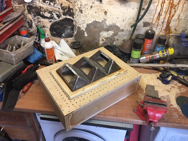

Very tempting! ive got to work sat morning however, so probs a not this time im afraid. Im near Carlisle so no that far.
I have however had enough time after work today to make a vac box...
and with the plastic ive ordered from ebay (above) im going to have a go on sunday (if plastic arrives). Heating the plastic will have to be in the [domestic] oven so ive ordered some spare plastic to allow for bo-boo's.

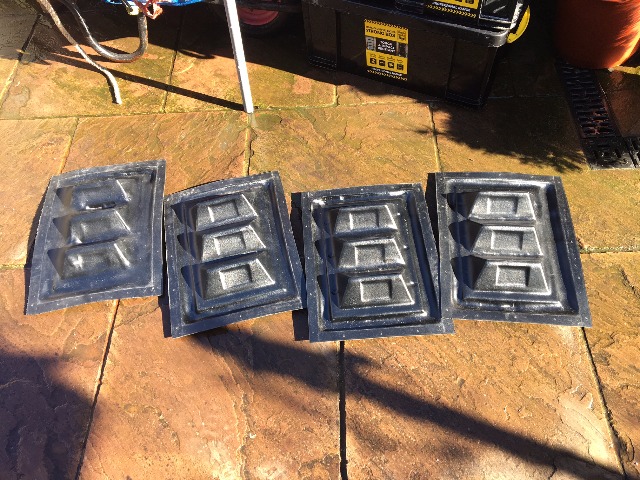

03 Jun 2017 17:00 #181721 by Riccy
Replied by Riccy on topic Roof switch pod
Plastic sheets arrived today :-)
finished off the vac box and made a clamp frame for the plastic sheet.
clamped in a sheet and had a go (well 4 actually, 1st on the left)...
Fairly pleased with them as a test run and a couple of them would be ok if carpeted, but generally i havent got enough suck and have problems with the heating in the oven (is too big so has to sit on a funny angle meaning uneven heating. might be better under the grille than in the fan oven).
overall... learned a lot for £25 spend. will probably carpet one and use that. Further attempts would need a smaller sheet & moulding to fit oven properly and more suck from the vacuum (could i use two together or would they cancel each other out?)

03 Jun 2017 17:02 #181722 by Riccy
Oh, and yes i did weld some plates over the large holes loosely, which allowed a bit of a dimple where the cutout will be :-)
03 Jun 2017 17:17 #181726 by Keithy
Replied by Keithy on topic Roof switch pod
Now that is a fair attempt....with a successful outcome!
Congrats you have a useable part Riccy!!
