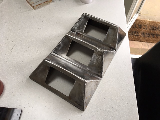

Bought a load of these for all the different things:

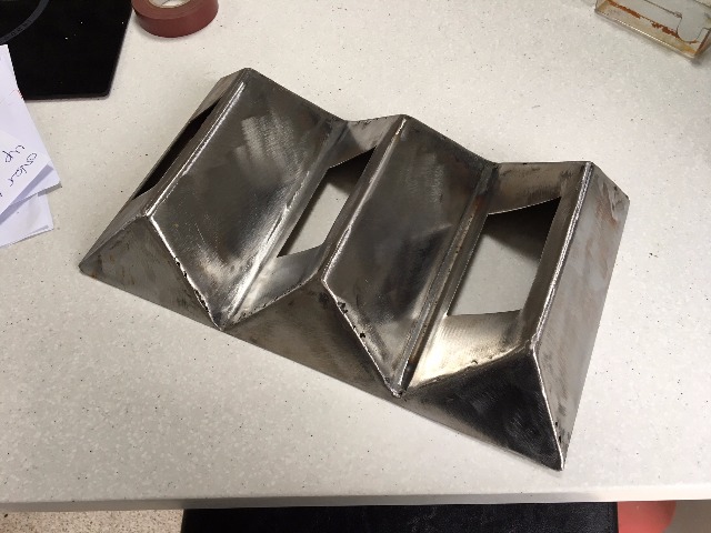

and made this for them to go into out of 1mm steel sheet:

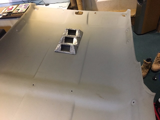

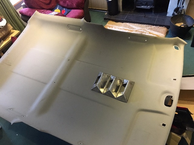

and pulled the headlining out for a clean and to make brackets on the roof for the pod to attach to:
But then a friend said - what about using that as a mold for vacuum forming?
I can see what he's saying because the metal is fairly heavy, a plastic molded one would be much easier to mount up there. So had a look and found this stuff:
and a video on youtube about how to make a vacuum forming box and heat the plastic in an oven. Looks pretty straightforward, but advice would be appreciated. The mould being steel could be re-used many times also

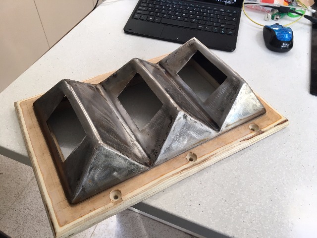

Thanks everyone for the comments... more progress...
Ive Glued it to a bit of plywood which has rounded corners and dimples for fixing screws,
This should make an edge that can be trimmed easily to the roof profile and provide fixing points.
Just need the sheets to arrive to start playing! (and to make the boxes)
Kiethy - my welding is really not up to much im using a gasless mini-mig at the moment, which is messy to say the least. maybe its time to invest in something better! Tig looks pretty difficult to get right.
For a vac i have an old 1800w bosch vaccum cleaner that has loads of suck once the filters are taken out, and goes straight onto full power when switched on (unlike my newer henry which starts at half power and has to be persuaded into full go mode). Im hoping this will be enough. i was planning to heat the plastic in the oven (good job i live on my own!).
