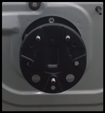

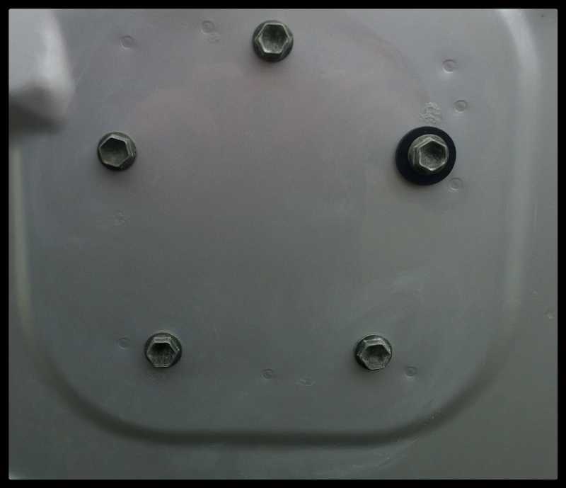

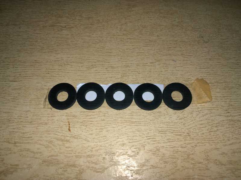

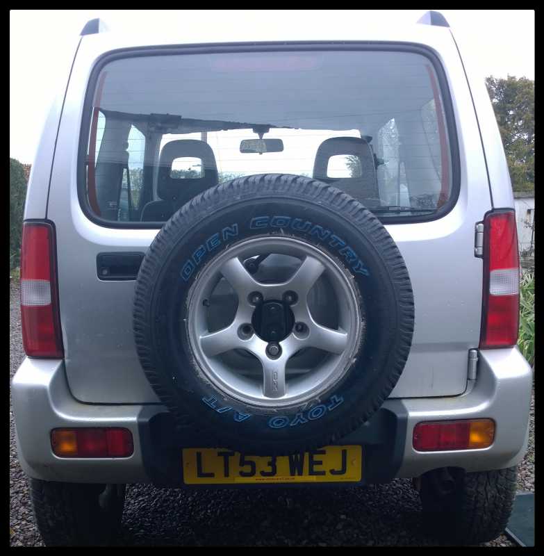

Hi all, just a quick update I rubbed the spare wheel holder down then painted it with hammerite. With disscussions before i bought 12mm rubber washers 3mm thick, there were 1&half mm but i thought just a bit bigger gap would let the water run down easier.
Then bolted all together
I then added the wheel
As you notice i have debadged the boot door also. So I have to take the car back to the garage to get a hole sorted then i can get the back finished so i can get out with my birds. Once this is done i will fit the rear tints i have as i dont want them damaged. So thats that for now,in the future when money and 1 comes available i would like to fit a spoiler and rear step

That's a very tidy rear! Looking forward to seeing the tints on. If it's the solarplexius kit you have do it on a warm day the when I fitted mine xmas day it was too cold and the securing sticky tabs on mine didn't stick for long on the rear screen But they do supply a generous amount to keep for spares.
