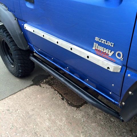

Bought a Riv-Nut gun the other day (as that Zanfi bonnet net still needs fitting) and then figured it would be ideal for filling in the holes in the doors when the plastic panels were removed after the larger tyres and then the Land Rover Defender arches went on...
Hmmm, and then got carried away as the line of bolts across the door crease looked a bit out of place (although not as bad as the holes that were letting water in on river crossings!), so i remembered I had two 5m lengths of aluminium box section behind the garage/extension...
Doesn't look too bad? Even more like a Defender! :woohoo:
I have no way of welding aluminium, so I carefully cut the box section with a slitting disk in the angle grinder (getting brave again now!) and then bent a tab over, then the top, and then drilled and screwed with self tappers...
Still got to do the other side yet though, maybe tomorrow... see how much tinkering time I get! :whistle:
