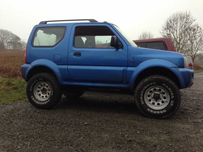

No idea if I have an arb or not. Complete amateur. I only bought it Saturday. How do I know if I got or need correction bushes and castor arms etc. I've always had standard cars and paid people to fix them when go wrong. Dumbass really with mechanics

Anyone got a link to some correction bushes or castor arms for my better handling. How do I know if I got an arb or not

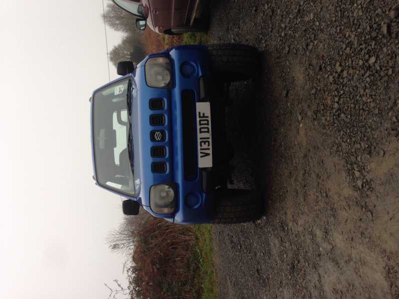

Cheers dude I'll upload some underneath pics and see what you all think is needed.
