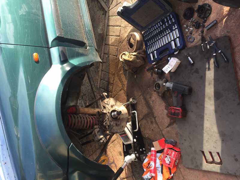

- Funky Diver
25 Nov 2015 18:11 #157183
by Funky Diver
Replied by Funky Diver on topic New weekend toy
So was the Liana engine a straight swap out? Or extra parts required?
- Chazg83
25 Nov 2015 21:36 #157212
by Chazg83
Replied by Chazg83 on topic New weekend toy
Wasn't to bad, had to use some parts off the Jimny 1.3 like the flywheel, sump, oil pick up, rockercover, few water pipes, complete inlet manifold but with liana injectors, prob few things I forgot but I'll have a look at me list I hadFunky Diver wrote: So was the Liana engine a straight swap out? Or extra parts required?
- Funky Diver
25 Nov 2015 22:26 #157218
by Funky Diver
Cool, so pretty much just using the Liana block and bolt everything on... sounds a lot like a 2 litre conversion on VW's...
