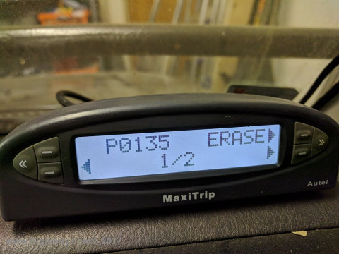

When I started her up for the first time, I noticed a couple of problems. The first was the engine management light (EML) on whilst the second was a stream of water and clouds of steam from the exhaust.
​My code reader showed P0135 which is the heater circuit on the top O2 (lambda) sensor. I therefore swapped the sensor out for a new one.
The sensor connector is clipped behind the cylinder head, right at the rear. I found it simplest to cut the cable tie style strap off the clip to remove the cable.
The connector is not easy to pull apart as a small tag inside needs lifting at the same time as pulling the connector apart.
I then used a lambda sensor socket to remove and replace the old sensor and reconnected everything up. I then cleared down the error codes, job done!
