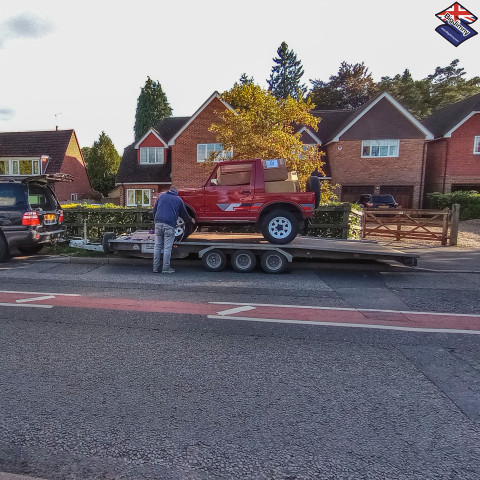

I had stripped off all the parts that I could easily remove including all of the interior apart from the dashboard and a few plastic clips used to retain the carpets etc.
The SJ was then loaded onto a trailer for the less than 1/2 mile trip to the restorers.
